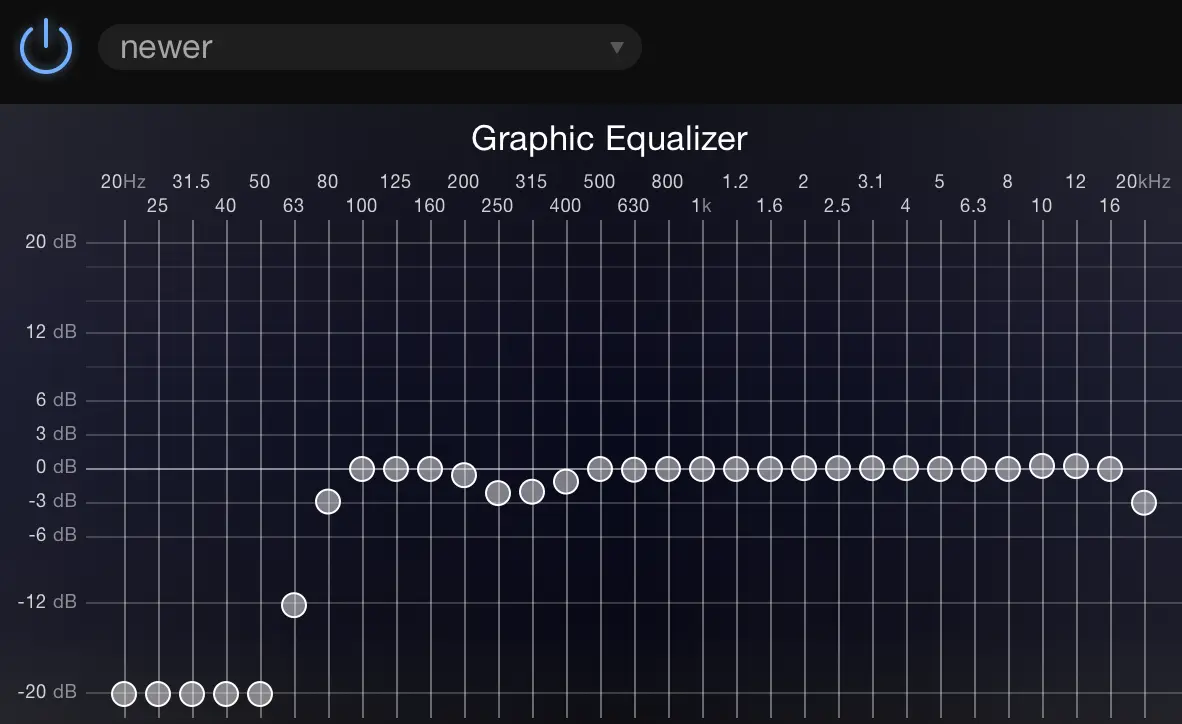

Hey Guys,
First post here :)
I am in to recording i have a carvin 4 x 12 cab and a sure Sm57
I get so much thud and low top end even when it sounds decent in the room - i always have to eq post recording.
I have tweaked the amps eq and got it to sound good on play back, but when you go and listen to the actual live sound in sounds awful - super high thin tinny just awful .
So my question is this - do i get a good live sound then mic it up and polish it with eq in the mix . . or use an awful live sound the records well with a flat eq...
signal path is this for a good live sound
guitar - Boss NS2 - overdrive pedal - compressor - front of amp - amp eq settings presence 7, treble 7, mid 5, bass 6.5, drive 7 - G system in loop with minimal effects slight reverb and delay and minimal eq tweets, no frequency adjusted more than 4DB up or down - cab mic'd with a sure SM57 1.5 inchs from the cloth on outer edge of dust cap - m audio mbox mic pre - garage band.. hopefully i have attached my eq settings in garage band..
the garage band eq I'm notching out below about 80z - another big scoop from 160 is t 400 is as i get awful cardboard type booming sound..
Any help tips - advice much much appreciated

Thanks so much guys for quick responses...
Im close mic'ing the SM57 on the upper right cone of the 4 x 12 - i have mic'd all 4 individually and tis cone has the brightest sound of the 4 of them . .
i have a condesnor mic which i will hook up as well as the 57 and blend to see how that goes..
heres an audio example with the eq settings i posted earlier - not to woofy or too thin ?
but non the less eq'd
feels like fixing in the mix which i understand is a last resort - or would you say just adding a bit of polish and that is ok -
i just want to get it right :)
Guitar sounds pretty good......now you just need to fix the rest of the mix.:D
Now that I'm actually looking at the EQ, you really aren't doing much. You have effectively used a high pass filter at 100hz, which isn't unusual, dipped the mud at 250hz, added a little midrange and brightness. None of this is extreme.
The only goofy thing about it is that you are using a graphic EQ instead of a parametric EQ for this. A graphic EQ is not very precise. A parametric EQ is a scalpel, while a graphic EQ is a machete.
You need to add a bunch of compression to the bass, so the finger slapping doesn't jump out like that. Or maybe back off the 3k and up range to take the harshness out of it.
Yeah, nothing about the guitars sounds too bad to me here. A bit 80s, but not in a bad way. The rest of the mix could use some work and a bit more time balancing the overall levels would help a lot.
Playing's pretty good too, by the way. :)

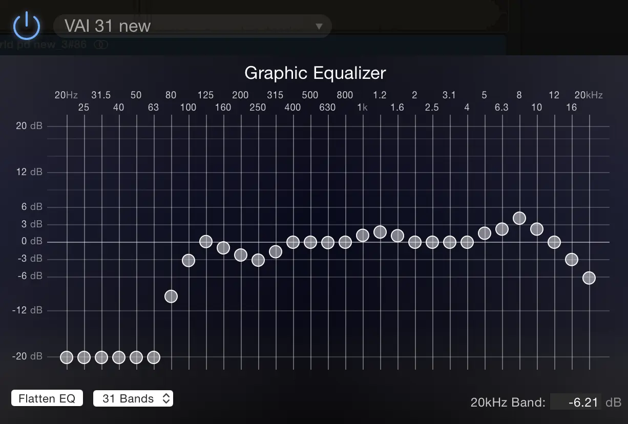

Hey guys,
Some again very great response's - over the last couple of days where time has allowed i have been moving the cab around and the mic placement etc...
One of the issues must have been i had the cabinet against a flat wall and it was facing another flat wall so perhaps direct reflections back at the mic ? ?
I have now moved it around the room a bit and found similar problems - so a long story short moved it to another room (which is actual smaller) but it about 3 feet from the wall at a jaunty angle so not parallel - result better !
I also added a second mic - i tried a condenser but i only had one of those cheap BM-500 things which sounded ok but lacked clarity so i just added a second SM57 to opposite (diagonal) cones.. again adds a more full sound..
i have also tweaked the eq in my floor unit ( TC G system and cut everything below 63hz) - big difference here
so with all of the above i now have an eq that looks very different . .
however i still get a bit of boxiness (hard to describe) tends to go with a dip of 3db at approx 250 hz
The 80's guitar sound although 80's and totally dated is exactly what i was after ha ha - 80's metal is going to rise again just need to be ready :)
ill post my eq and another sound clip if you have time to review -
again much appreciated help - this is probably the only forum that has ever been productive lol
