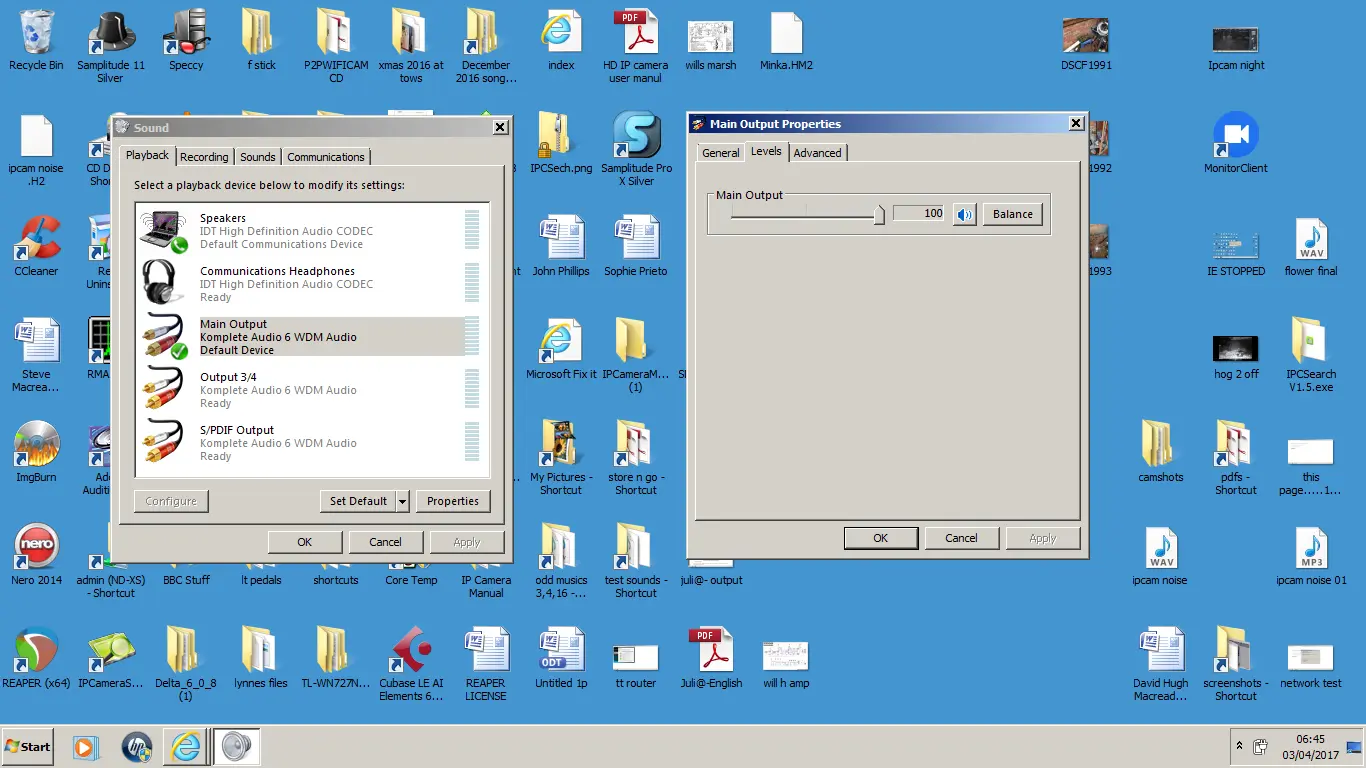

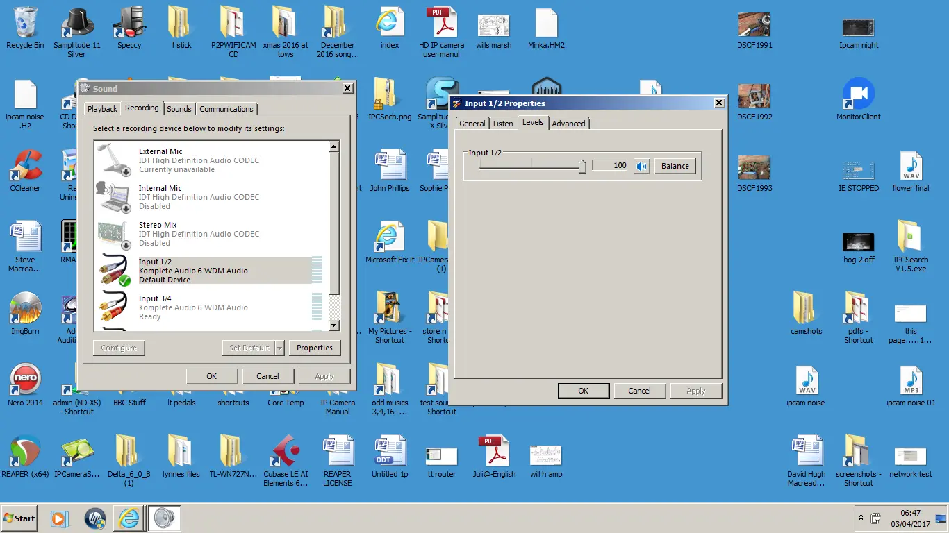

Don't have an Audio Box, Studio One nor an RME (slurp!) but, AFAIK the settings for W7 as attached hold for any ASIO device?

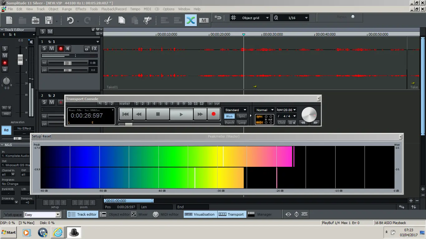

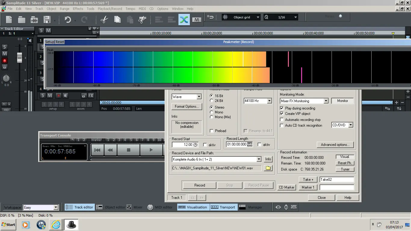

Rather tricky "snapping" the same meter reading for record and playback but the levels on cans were identical.

Thanks for posting that, ecc83. I checked, and those settings on my system are OK.
