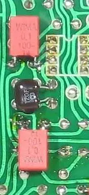

You "parallel" the lytic on the bottom side such as done in the enclosed photo.
I am sure your budget is not sufficient to warrant replacing the lytics with equal value film caps!!!

Ok, now I have two opposing opinions to contend with. :D Thanks for the pic GCalo. I see. So you do them all with .01 mFd caps? Even the power supply?
