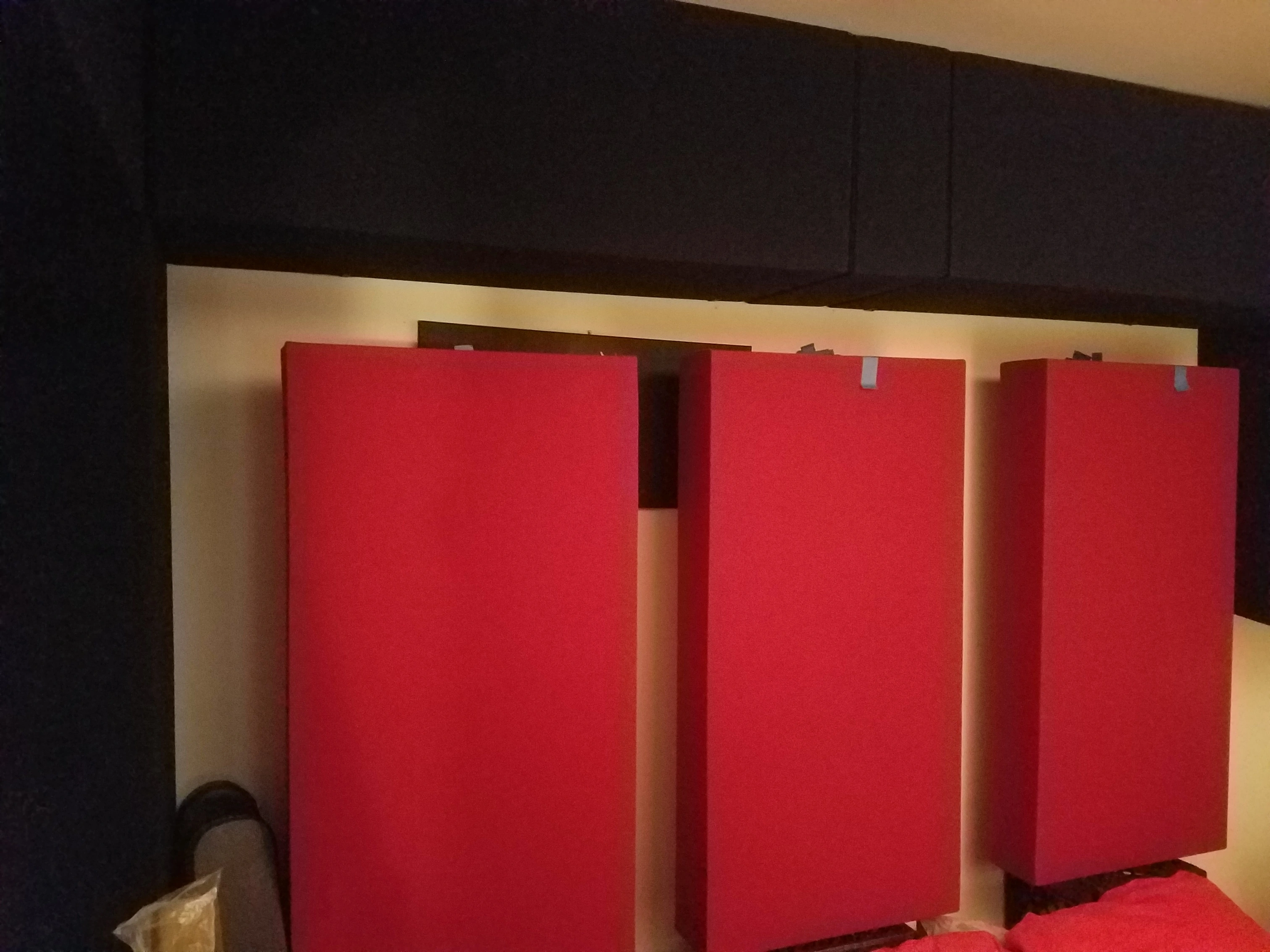

My room is 11' 6" x 18' and am about to do some measuring, but before I do, I have a rear wall question.
The side/back wall corners and the ceiling/back wall corner have 17" x 17" soffits filled with Roxul Safe'n'Sound. (Black)
The 3 panels for the face of the rear wall are 6" thick (with the sides cut-out for a little extra effectiveness) and will each have an air gap of 6". (Red)
At the moment, distance between each panel is approx. 7". (Pics attached).
My question is....
Shall I leave the 3 Panels as they appear in the pic, or shall I add 1 more panel, making it 4 panels in total, so as to make it more of a solid wall of coverage?
Which will be more effective?
Thank You

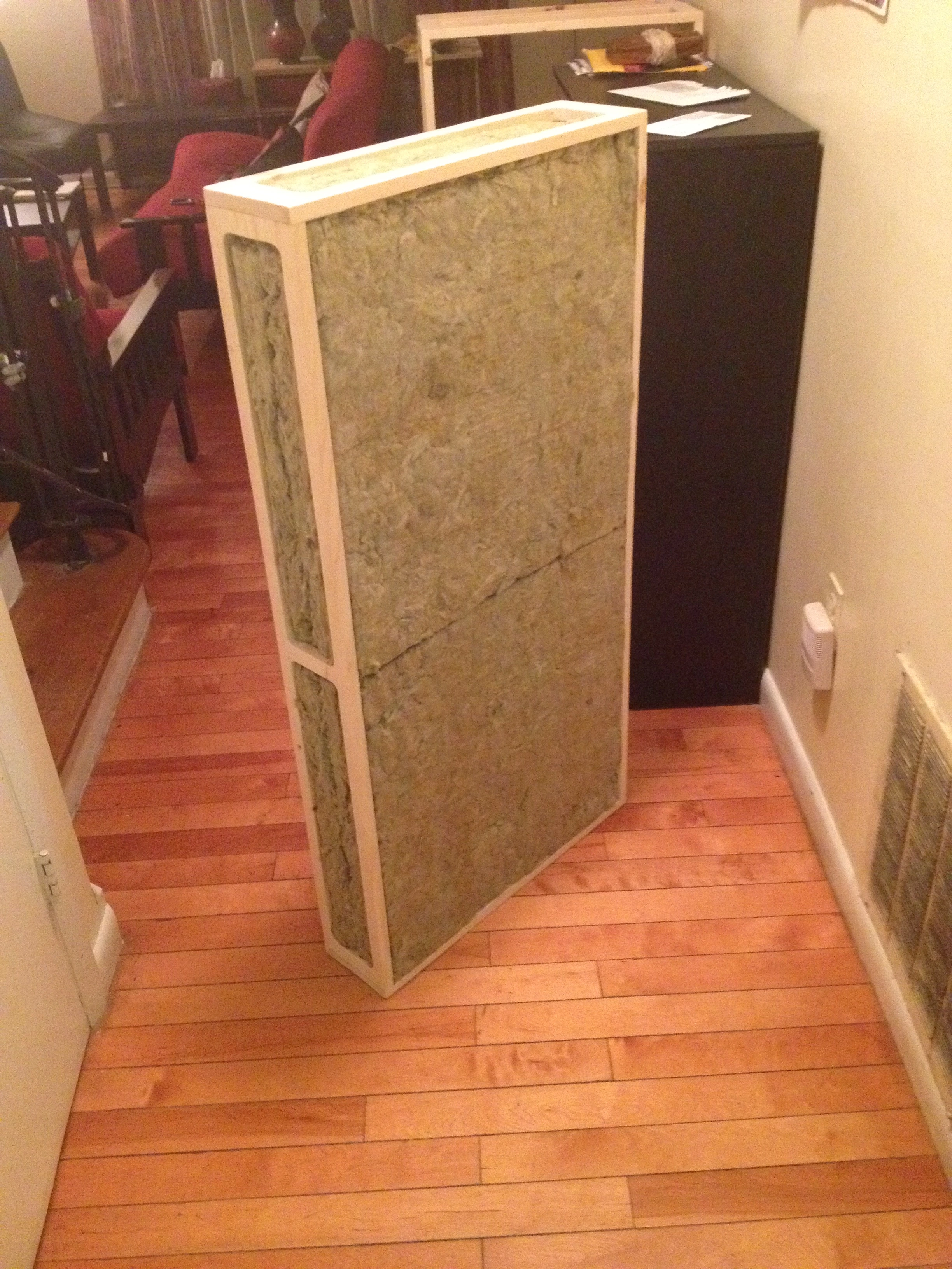

One more panel won't make that much of a difference...so go with what works better for you esthetically...or you can even consider adding the forth horizontally, above the middle one, if you're looking for a place to use it.
Also...it's not a bad idea to have something on your front wall, especially if you have rear-ported monitors...so you could stick it there too.
Nice job on the framing and the overall build.
I built some big traps like that too a couple of years back...I have 6 of them, but I didn't go for the open sides.
Did you cut out the holes from solid pieces...or did you frame it out from strips?

I used a jigsaw to cut the holes from a panel of pine.
Id be playing around with rew and a measurement mic and seeing what position got you the flattest response rather than looking for generic position advice.
You're not going to get much difference moving a trap a little to the left/right or whatever at the back wall....I mean, not enough that you can see a noticeable change in the flatness of the frequency response. Corners/margins a good place at the back wall...so just go with what fits your layout.
I spent a few days with REW and moving big custom traps...and there was no "AHA" moment with any particular position.
