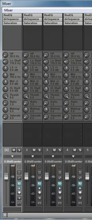

I think it would be cool if reaper had actual channel strips rather than just mixing faders.
I understand that the fx plugin thing is there, and the phase inversion is nice... But a simple eq and maybe even other channel strip configurations would be the icing on the cake, IMO anyways...
You mean something like this? (see attachment)
1.) Right-click Master track > Show FX parameters when size permits.
2.) Add your FX
3.) Click on the blank knobs in the mixer to add whatever you'd like
4.) Click the "FX" button on the mixer: FX > Save chain as default for new tracks
Now you should be able to set your view as either a screenset, track template, or project template. I have mine saved as a 16-track project template. You can set it as the default in Options > Preferences > Project
Heh I hope that helps you out a little :)
2.) Add your FX
