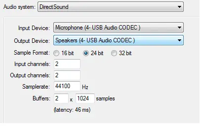

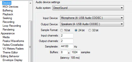

you can't lower the 1024?

oops! Sorry man - did you change everything back?
Well, of course. Gecko is right. I turned the Mix knob to Preamp (instead of computer), and I actually can hear my mic now (no delay) through my headset (that is connected to Interface). But I can only really hear clearly when the front gain knob is set to AT LEAST 95%, and the back Level knob is set to 100%. which is of course a problem... its clips at anything over a whisper. even with the level turned down on the track window in reaper
It's most likely not even a latency problem, and is more likely to be associated with the interface. Fat-fleet suggests adjusting the mix ocntrol on the interface, and that, I think, is the first place to start.
