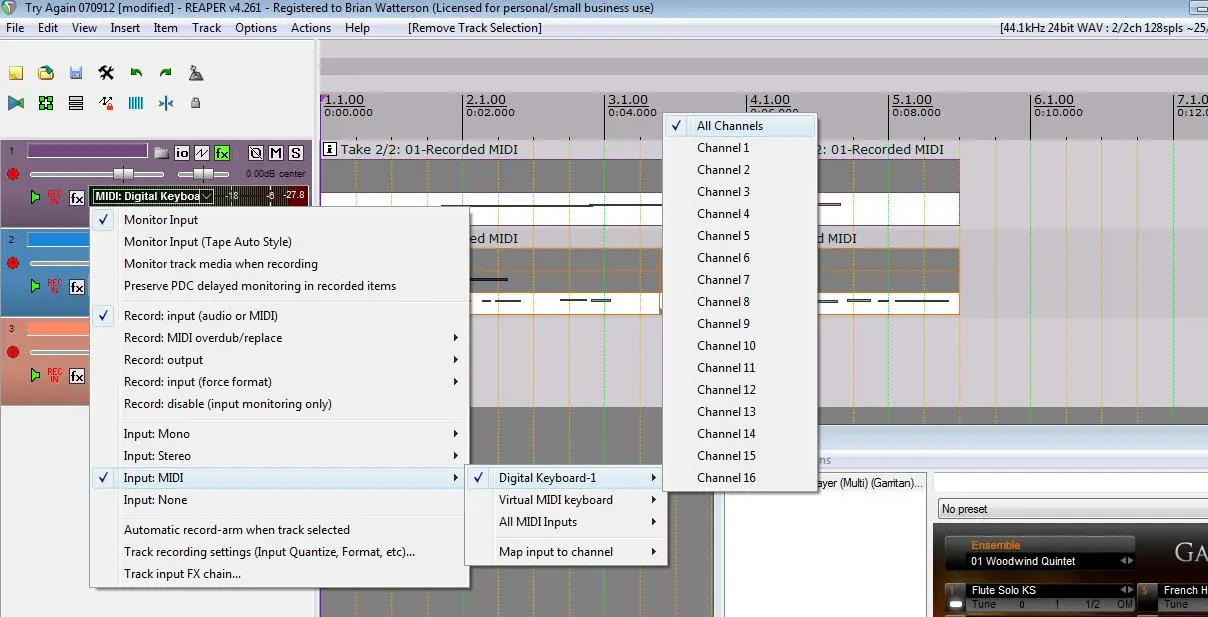

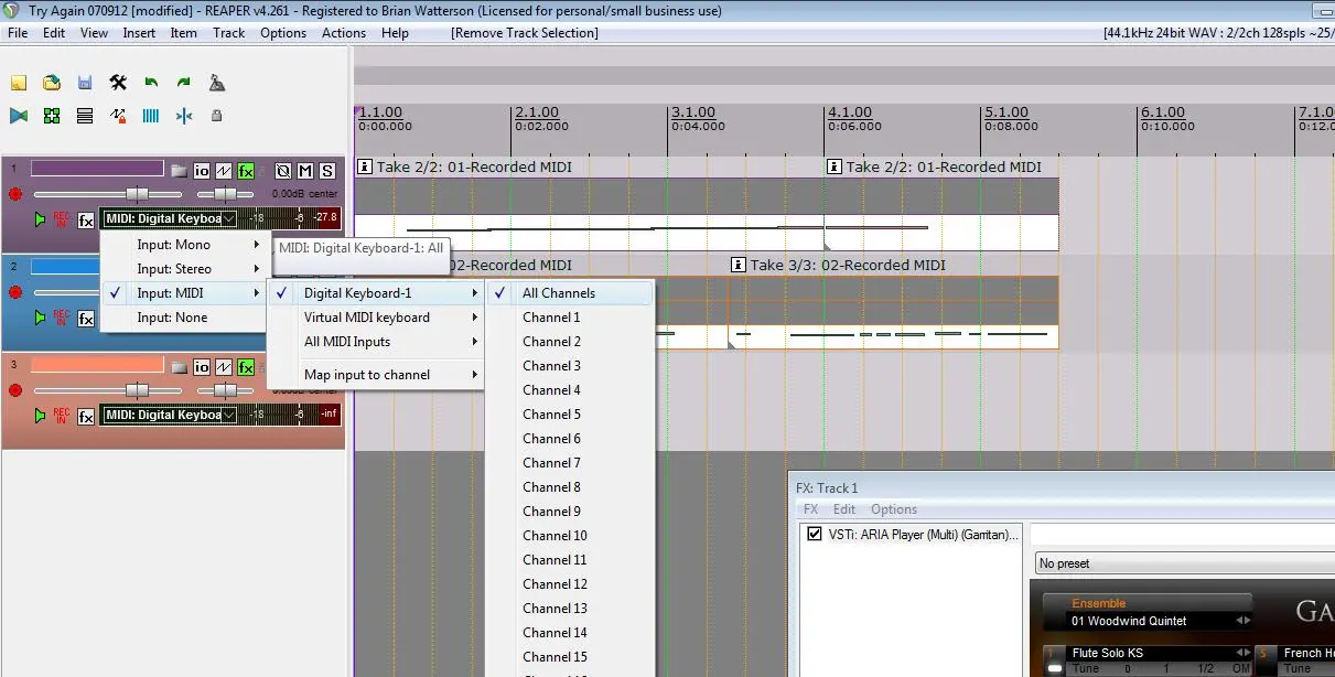

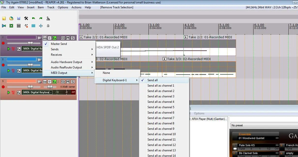

Hi Guys - Only my second post on this site - hope I'm doing this right!
I am a complete beginner in this area of recording music & I have a problem (well, lack of basic knowhow really) which is probably second nature to most of you, but I can't figure out & is delaying me & driiving me crazy with frustration.
Briefly, I bought REAPER recently. Also installed GPO 4 (and the Manual).
I can't get ARIA (GPO 4's sample player) to play multiple instruments. I am having to load up 1 instrument at a time on separate instances of the ARIA player. So I end up with several images of ARIA (each containing 1 instrument) on the screen at the same time - which is obviously crazy.
When setting up to record - adding new tracks & instruments etc - there are several menus needing the right choices & this is where my problem lies. I don't know which choices to make!
I have added some screenshots below (I hope) to show how I try to set up at the moment, but it obviously isn't working. I would be really happy - & grateful - to hear from anyone who could give me some really basic, step by step, guidance to get me setting up correctly (& making the music)! Many thanks in anticipation.
I don't know crap about MIDI, but I assume if you want to drive several instruments from one player, you need to send the MIDI signal to it for each one on a different MIDI channel. Looks like you have each one on 'all channels'
