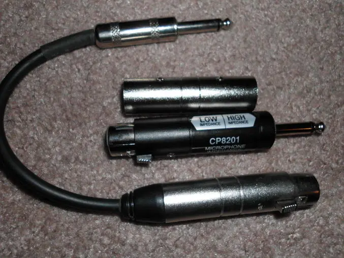

I have made these work previous to purchasing a reamp box. Around $25.

Jimmys69-that seems like a good technique, i remember seeing some very similar adapters when i was about 6 i wonder where they are now?:confused:
