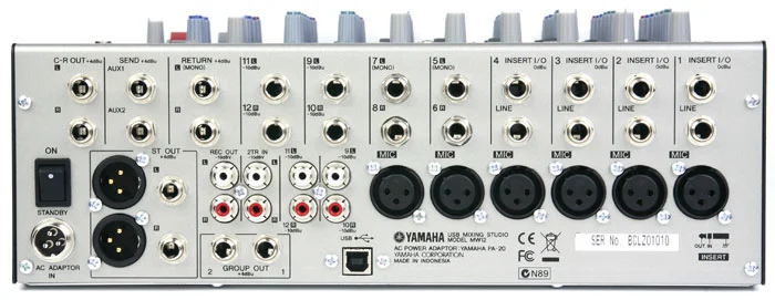

hey, so im looking to record my drums i have done using my only mic....
ideally i want 8mics and just wondering if its possible using my current. I've uploaded a pic of it. As you can see there's 6mic ports but what is there room for more???
how can i get "room" for 2 more mics, besides buying a new mixer...:confused:
If you had a two channel mic pre, you can run them into chnls 9/10 or 11/12.
ya, just instead of xlr mic cables get xlr to 1/4 inch cables and run em into the split channels.
