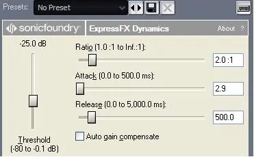

On lead vocal, I'm curious what you have for an attack setting on the compressor.
The compressor settings are shown below....

Nice vocals too.Interesting to "look" the vox comp settings...a bit more comp would be an option (ratio,maybe?)

Maybe a bit more automation there... I tried more compression but it started to suck the life out of it....:rolleyes:
