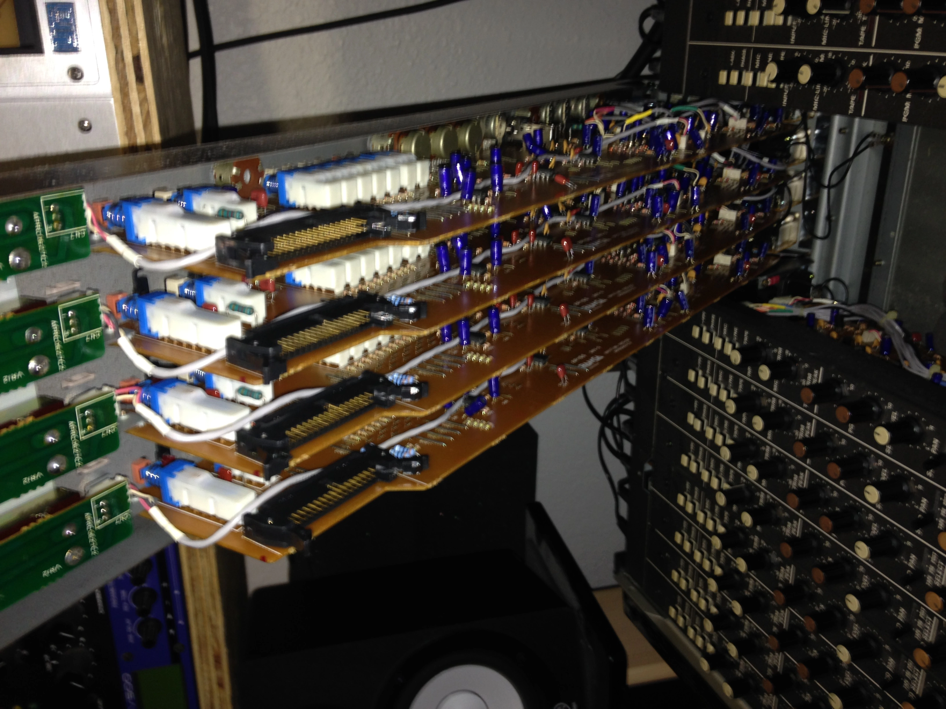

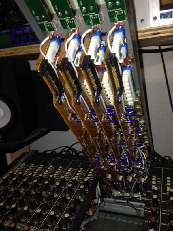

Arenthe channel cards connected by any kind of a buss PCB? Like a PC board that goes across all the channel cards?
