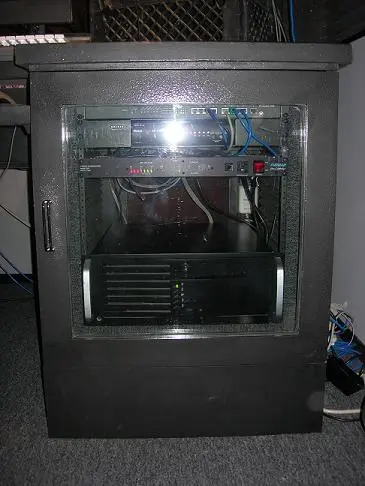

OK, here's a couple pics. The first one shows the isolation box with my computer and other equipment mounted inside. I still have 4U space left in the rack to mount a second computer if I wish.

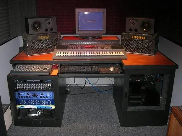

The second picture shows the studio desk I built with the isolation box as the right side support. I am still not quite done with this project (the Darigold crate monitor stands are only temporary :rolleyes: and I clearly have some cable management issues to contend with still), however I'm getting close and this is working out well. Once it's complete I'll try to post more detailed pictures and a description of the project.

Here's the isolation box:

And here's the desk:

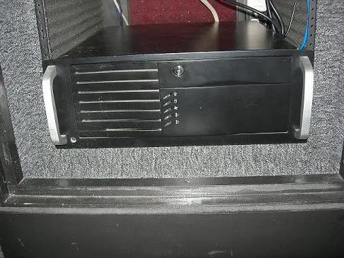

OK, while I'm on a roll here, I thought I'd post one more picture. This is a closeup inside the isolation box so you can see how the PC looks mounted in the rack:
