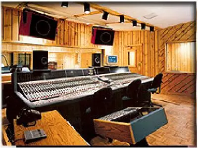

here's an example of what you can have if you want to give me 180 psf (Not including any gear or the low voltage wiring of course)
I don't have all that experience with building. But I have landscaping and drainage system experience. I have two brothers who are equally competent with tools and manual labour. One of them is an engineer and he is building a house in the upcoming months. I also have a friend who just graduated from UT and has been working at the studio on campus and is interested in studio/music business. So we have 4 guys who all think manual labour is fun when planed out right. I don't think I will build anything in the next year or ever if the proper situation doesn't present itself. However, It is always nice to have things to think about. Between applying to jobs, applying for graduate school or thinking about trying to go into music I just like having information.
p.s. - I have been checking out your progress since the beginning. I haven't been involved at John's site really just lurking and snaging a couple .sdr drawings to study to learn. I know most people here have the same ideas, since i was 14 with my Yamaha 4-track I wanted to have a real studio. Studio Building and Display and John's site get most of my attention in the past year. I just don't really find the same mic-pre/mic/recorder/soundcard questions too informative anymore. Sometimes I pop in to try to put some reasoning into people buying $1000 soundcards for their first ever recording experience. I've tried a bunch and settled in a price/preformance point that is mobile enough for someone in an apartment who records remotely for other people or sometimes in his closet. It is the little step up that interests me. There was actually a studio centrally that closed down last year. I can't remember what it was called, but it was on 42nd and Guadalupe. I am not sure if land tax killed it, but it was the perfect location. The guy never let me in though to look. He probably thought I was going to scope the situation for a break in or something. I will keep lurking.
You can build a real nice studio for that money - but not what I built.......
Our profit margin on that project was only about 15 psf. Nothing to retire on. (about 40,500 for 8 months of our lives)
Actually that particular studio is about 2700 sf and is a world class studio.
4 iso booths - 2 large ones (drums and strings) which can open into the main room, PLus a medium and small vocal booth.
24' ceilings in the main room, a large tech room and a great wiring room behind the control room.
The control room is on an elevated slab that is 14 to 20" thick with a vault below for future wiring access to the board.
This is the ultimate "room within a room" sitting inside a building of reinforced concrete block construction - tall enough that you can completely walk on top of the studio built within it. (Remember - the 170 did not include that structure - that building was an additional 640,000 and also has support space for the studio and office space for the company)
A low temperature underslab heating systems is installed and the HVAC system can run full tilt in any room while recording without noise problems.
Humidification/dehumidification systems were installed to maintain humidity levels =/- 1.5 %.
All in all it's a hell of a studio - and can house a 60 piece orchestra. 75 if they really like each other......
