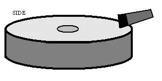

So when you mic the top, it should look like this? Or should the mic be pointed more towards the head of the snare?
We'll be going back in to do more drums here in the next couple weeks and I'll have him readjust his kit so that I can mic it properly.
That's fairly close. If the drummer is hitting the mic while it's in that position, just grab an extra drum stick. Stand behind him while he records. Whenever he hits the mic, hit him upside the head with a drumstick. Trust me, he won't hit the mic very many times. :D
