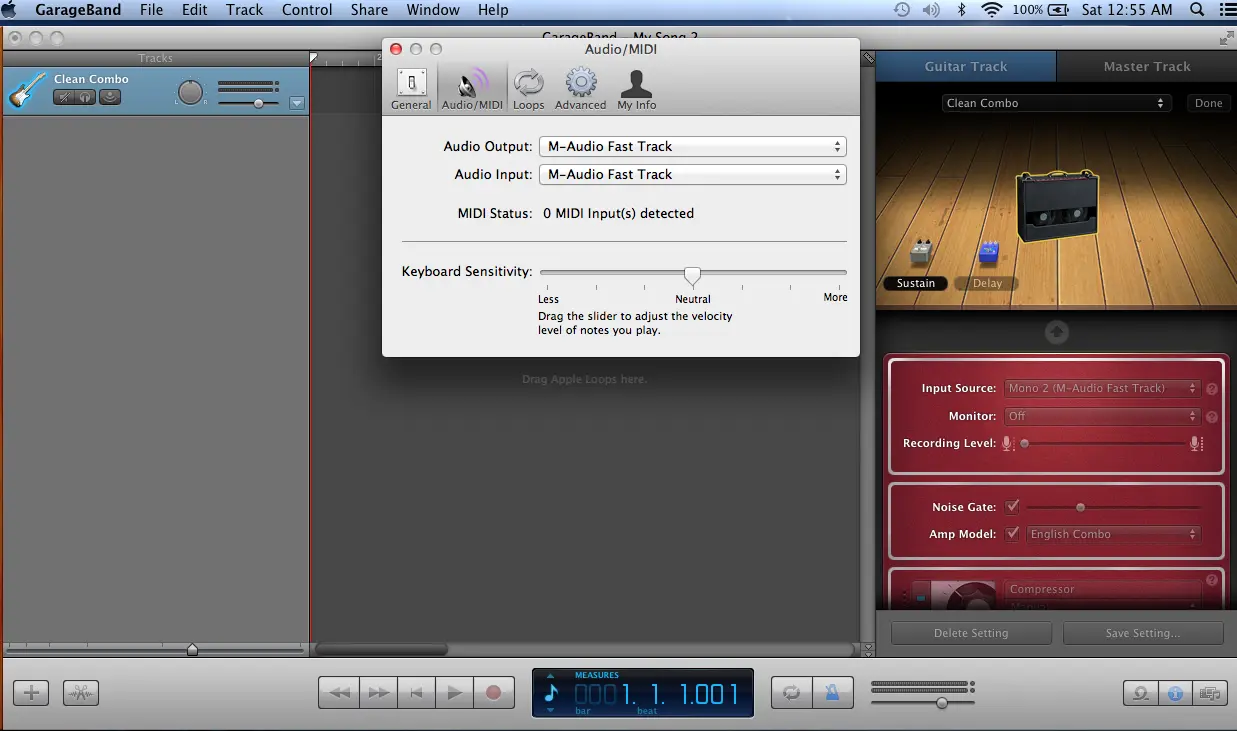

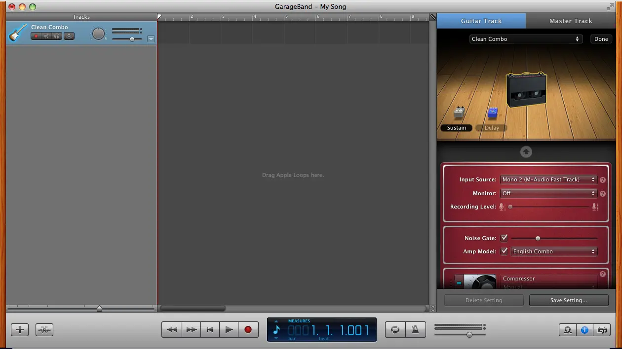

Be aware that you may have to select your audio interface in BOTH the GarageBand preferences AND in Mac System Preferences > sound. I noticed that in your second screenshot the GB recording level was at zero. That slider correlates with the slider shown in Mac System Preferences.
