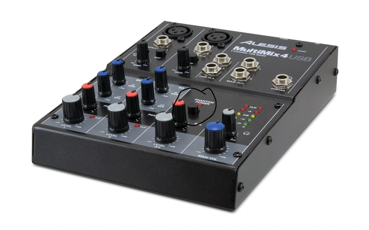

The Alesis Multi-Mix 4 has a phantom power switch. See my attachment.
Just a hunch but are you using an XLR to XLR cable? If not and you're going via an XLR to TRS jack that won't have phantom and WILL be your problem.
OK - missed that when I looked at the pictures on line.
Make sure that the phantom is switched *on* and that you use an XLR to XLR cable and do *not* go into the jack socket.
