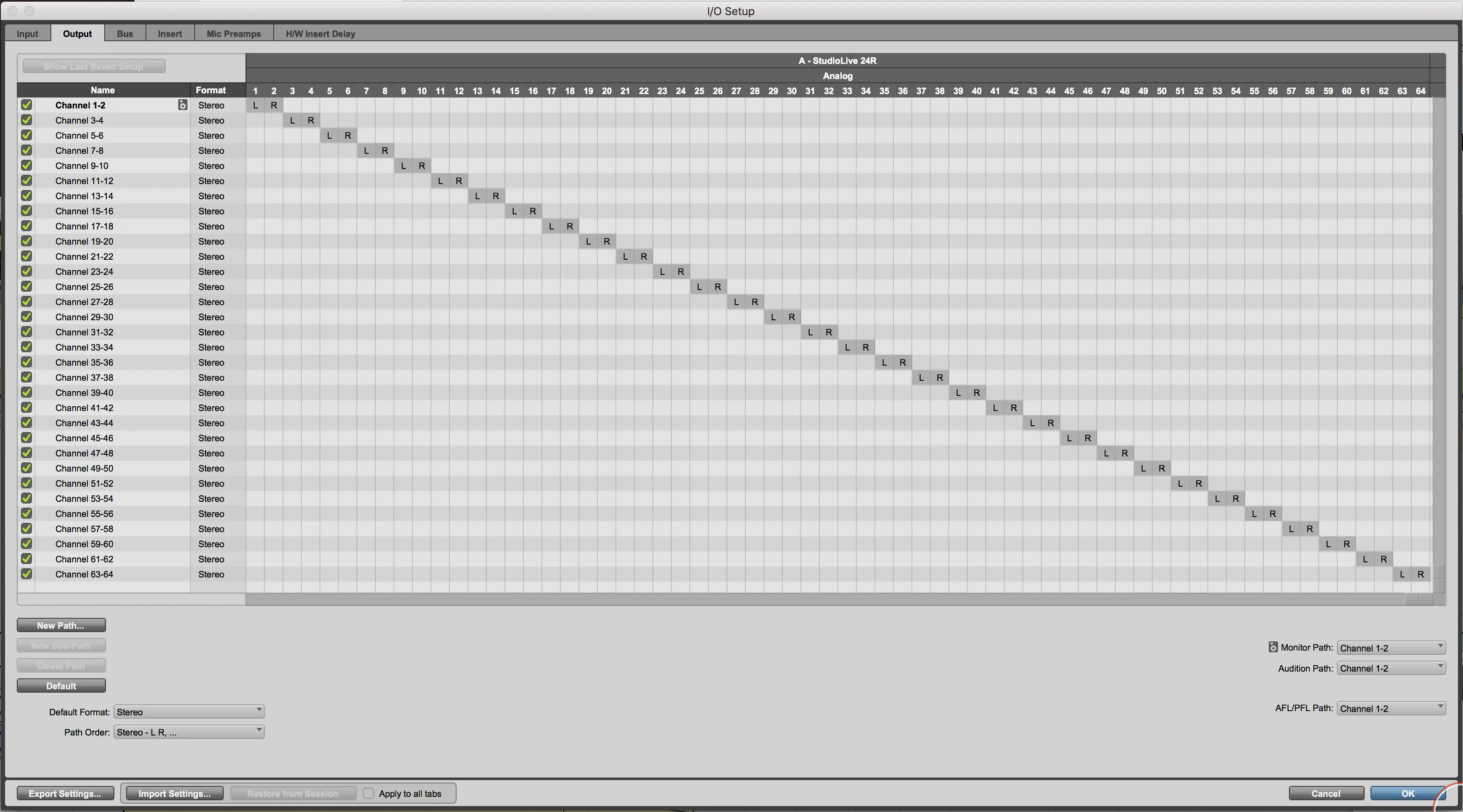

Pro Tools had no problem working with the 16.0.2 console, but I can't get it to playback through the 24R. PT sees it in the Hardware Setup, Playback Engine, I/O setup is showing 64 channels (32 stereo pairs) in both the input and output, compatible with the I/O in the 24R. The only thing I can get out of the 24R, though, is what's coming in through the inputs. Nothing from Pro Tools.

Which outputs are designated for monitoring in your I/O setup panel? I don't have presonus, i'm using an A&H Qu32 and I have channels 31/32 as the dedicated PT playback stereo output. The A&H has internal software routing that has to be set for internal/external (they use the terms "USB" and "Local"). So if I want to listen back to the channels from PT separately I have to switch AH over to all "USB" inputs and to record without latency through the monitors I have to set all the inputs on the A&H that are "live" to "Local" and leave the 31/32 for the playback of previously recorded tracks by setting 31/32 to "USB". I would assume the PreSonus has some sort of similar settings to prevent a feedback situation.

I'm using the default settings, channels 1&2 out of Pro Tools. This is what has traditionally worked, and has been working with the PreSonus StudioLive 16.0.2 console I've ben using. I also can't get anything through the 24R when I select it in my system sound prefs, then play something through iTunes. The 24R just isn't receiving, though all my input signals are showing in my Pro Tools project.
I heard from someone else that because the non-HD version of PT only supports 32 channels out, and the 24R has 64 in, I might need to "re-patch" the inputs in the 24R to match. Not quite sure what that's all about, though.
