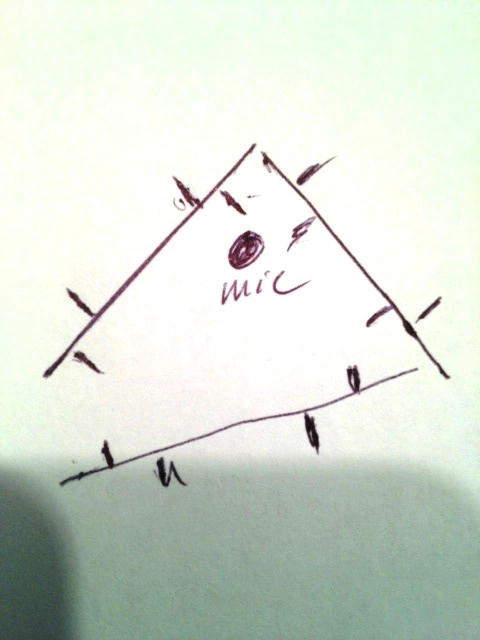

Under $100 for the PVC stands. I did not glue them, so they break down nicely and fit in my closet. I had 2 professional movers blankets that were given to me. I think that Harbor Freight tools sells a pack of 4 moving blankets for something like 20 bucks.
When I actually record vocals, the stands behind the mic get moved in pretty tight, angled at around 30 degrees, and the stand off to the right in the picture gets moved in very close behind me, and at an angle of 12-15 degrees.
The "room" gets pretty small.
The footprint looks something like this:
