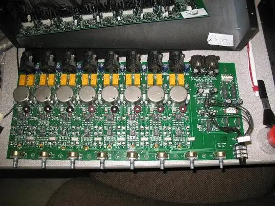

PS Here is the main board

I've been plugging away on this preamp for a while. Time for an update.
So far here is what has been done:
- swapped out the stock (China) transformers for Jensen JT-11K8-APC. Let Jensen know that these are for a Presonus and get a discount ($30 each)
There is a good writeup on how to do this here:
http://www.imjohn.com/PresonusJensenXfrmrs/TransformerSwap.htm
- Installed BB OPA627PA IC in place of the 5534
- Installed 3 new insert jacks to replace those damaged by a PO using screws that were too long on the cover.
- Installed a new set of original knobs.
Changing the transformers is a big job that should be done carefully and without haste. Most can do it if careful.
The top cover uses 1/4" long screws (I need to measure so don't quote me). Some were lost by a PO and longer screws were used. There are a few places where the longer screws went down into the insert jacks and messed them up. This is a good time to talk about Chad Kelly and Presonus support.
In looking for replacement jacks I contacted Presonus. The degree of support hat I got from Presonus and from Chad Kelly was outstanding. I can recommend Presonus fully based on the support I got. It turns out that Chad had done the final testing on this unit when it was new. His signature was in it. Support above and beyond! Plus a lot of information on the unit.
TODO: Right now the biggest thing is that the gain pots are noisy. I have a set of replacement pots coming from Presonous that I will install soon.
I might replace the output coupling caps. They are Nichicon and not bad but I might want to try some Muse there. Chad says that there is minimal (if any) audable gain.
