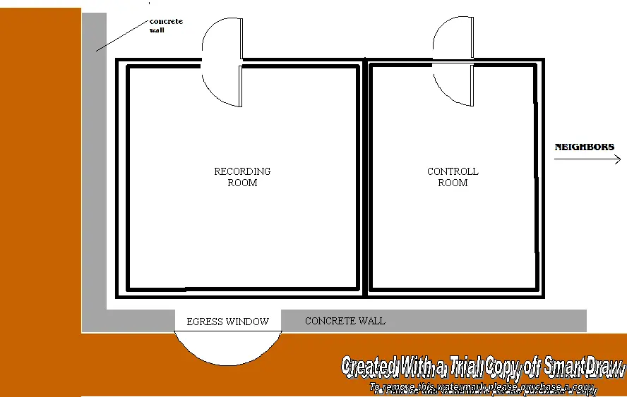

Hi everybody. I've been working on some drawings of basic studio consruction. Now I now these are redundant and have already been posted but I just want to make sure I understand the principles and how they might be applied in my situation. I'm moving into a house in two weeks which basement has concrete walls and PLYWOOD-on-joists flooring. Underneath the floor is a foot or two of crawl space. So, it's different from your typical basement. Now, I'm gonna try to post some pics. I hope this works. Here goes.

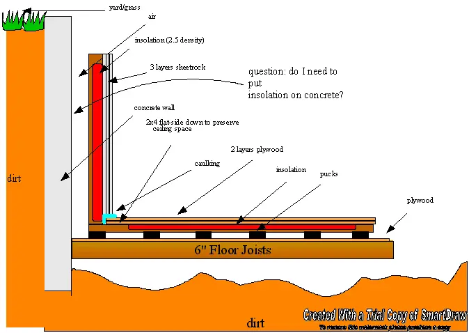

Great. That worked! Now, I didn't include in that drawing that I also have neighbors towards the upper of top direction of the drawing. So, the idea is to have the studio in the corner of the basement that is the furthest away from my neighbors.
Also, since I will have concrete walls on two sides I'm not sure how much construction is needed on those sides. Here's what I'm thinking of doing, but this might be over kill.
So, I haven't a good look underneath the floor, yet. AND, I haven't spoken to a structural engineer, yet, but I hope he doesn't tell me I have to hang the walls from the ceiling which is not out of the ordinary in Denver (because of expanding soil, I think?) Anyway, I wonder what might happen with all that space under the floor. Will it act like the inside of a drum?

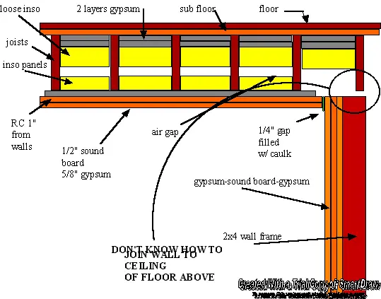

OK,this might be premature, but since I made this drawing I want to post it. This next one is my attempt at understanding how to soundproof the ceiling above. In this picture, I ask about how to attach walls to floor joists above. Let me know what any of you think. Thanks.

Hello Hummarstra, your drawings are just fine. However, I have some comments for you.
Your PLAN VIEW shows, among other things, THREE LEAVES, between the two rooms, and your VERTICAL SECTION also shows THREE LEAVES at the exterior wall. Remember, your CONCRETE WALL is one leaf. Take out the wall between the concrete and your interior wall. Also, forget the soundboard. MASS is what you need, and although they call it soundboard.....IT AIN"T :D
Just substitute another layer of 1/2" drywall between the two layers of 5/8".
Also, take out the center wall between the two rooms. Each room is it's OWN LEAF, with an AIRGAP between them. But here is another thing to check with BID about.
Normally, all walls will have a FIRESTOP block about half way up the wall, in every wall cavity. But in this type of construction, since you have an airgap, there is NOTHING to stop fire from going up the interior of the wall. Now, I'm NO EXPERT, but this MAY be an issue in your location. I have looked on the internet in this regard and some cities allow FIBERGLASS insulation as a firestop between DOUBLE PARALLEL walls, IF YOU FILL THE AIRGAP with insulation at least 16" from the floor upwards. But DON"T TAKE MY WORD on this, as one member here lives in a location where the codes require all EXTERIOR walls to be sheithed on the INTERIOR with drywall. As you have concrete exterior walls, this wouldn't apply I think, however, you need to talk to BID about the applicable codes in your location.
Ok, about the floor. YES, it will act as a drumhead. Again, I'm no expert, but I believe you only have a couple of things you can do about it. ADD mass to it, and add insulation in the JOIST CAVITIES :eek: :( (no fun!!) But this ALL DEPENDS on what the structural engineer AND what the codes require.
BTW, you don't show, or have told me HOW the existing basement floor FRAMING ties in with the CONCRETE WALL. :confused: You mentioned the STEEL BEAM in the center, probably running the LONG dimension, but not how or what supports the joists AT THE WALL. AND if there are piers between the steel beam and the wall, which I doubt, but you never know. So, as to your PROPOSED "floating floor", the SECTION drawing looks ok, however, this still depends on the codes and engineers ok. He MUST know exactly what you are planning, and what exists, which I'm sure he will look at. But let me add something here. Some information has come to light in the last week, that you should read.
These "pucks" that "supposidly" decouple the new structure from the existing, are supporting not only the WHOLE ROOM, but equipment and occupants also.
Because of this "loading" on these isolation pads, compression takes place, and from what I understand, now they display a different "resiliancy function"
that may actually change the resonant frequency of the structure itself. Or something to that effect :confused: :p . Because of this compression, shape, spacing, density, "springyness", dampening and other factors must be taken into consideration when specifying these pucks. Because so many people here and elsewhere have built floating floors using "net fact" specification of these "resiliant pads", it has almost become a cliche solution for decoupling floors. But now, because of this new information, I am hesitant to continue offering my opinion regarding how to do this, as I believe it is MUCH more difficult to correctly calculate this stuff than I previously imagined.
Calculations for SPECIFYING these, are VERY VERY difficult and from what I understand, if done incorrectly can actually AMPLIFY some frequencys. Now I won't pretend to know much of anything in this regard. I have read quite a bit, and some of it makes sense, but MOST of it is WAAAAAAAAAAAAAY beyond my abilitys to comprehend. :rolleyes: But I DO know this. You ALREADY have a floor that is a DIAPHRAM, which means, it will ALSO affect the NEW structure, as it too has a resonant frequency, AND an airgap which MAY or MAY NOT, ALSO have a resonant frequency IF SEALED. SOooooooooo........
at THIS POINT, it may behoove you to procure some PROFESSIONAL consultation in this regard, as it MAY turn out to be so technically and financially difficult to rectify the situation to achieve your isolation
goals, that it might be better to lower your expectations. In any event, to prevent total failure or disappointment, and wasting time, money and effort, knowledge is the key. This existing floor, Denvers codes, and your isolation requirements are a quagmire that in my opinion, demands Professional expertise.
As to the new walls/existing ceiling joist connection, this is done in two ways that I know of. Either a "decoupled sway braces", or capturing the top edge of the wall in a custom built"channel" with continuous rubber gaskets on
all three faces of the channels interior. This decouples the wall, and blocks the path to sound flanking over the wall. Walls perpendicular to the joists, require decoupled blocking between the joists OVER the wall too. But there are MANY little details such as these to look at when the time comes that all your code and structural conflicts have been resolved. THEN, you can look at all these details.
Well, thats about all I have for you, untill some of these questions are delt with. Good luck, and keep us up informed of your progress.

I don't yet know how the floor joists are connected to the concrete walls. That'll have to wait till I move in.
If the steel beam were pictured it would run from bottom to top along the basement ceiling.
Point well taken regarding the pucks. I think this floor will be particularly problematic.
I've already seen the info on sway brackets. I was just hoping there was an easier way to do this. I guess not.

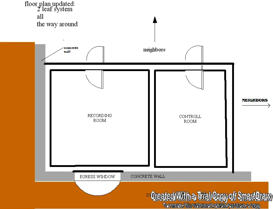

OK. I updated the floor plan to include only two leafs all the way around.

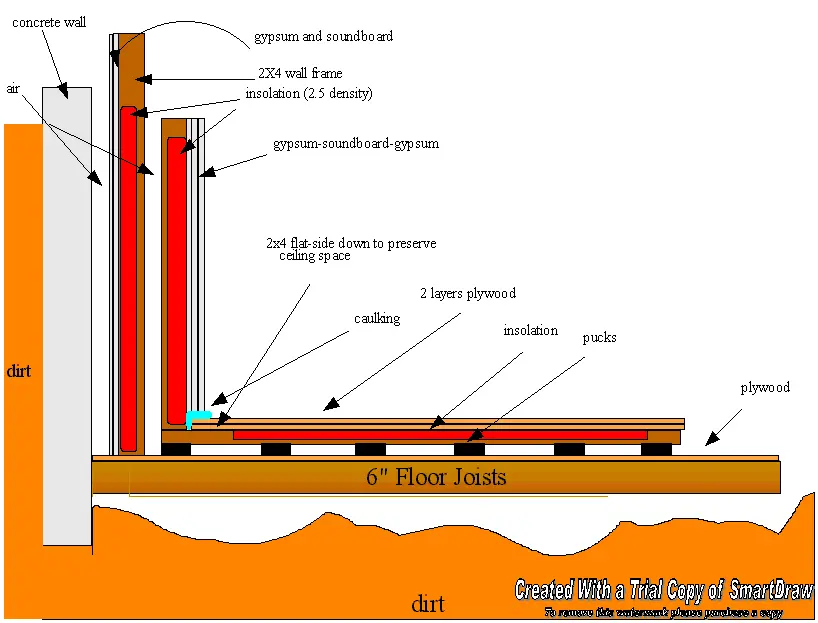

Here is a new pic of the wall leaf design up close. But, do I insolate the concrete wall, too?

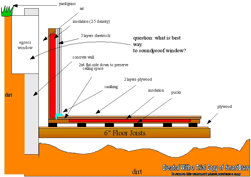

Well, here's my other question: how do you best soundproof an eggress window.

Hello Again. Your plan and sections look correct now. Couple of comments.
Regarding the insulation on the concrete wall. Yes. Two ways to do it. Attatch vertical furring strips to the concrete at 16"oc to provide a fastening point for plastic strapping to hold the batt insulation in place. Use 1x2 even though the insulation is thicker. Or you could simply drive concrete anchors at 16" oc, 4 high evenly spaced, as a tie off for wire. As you place each batt, pull the 4 wires across and wrap around the anchor(leave the anchor sticking out an inch.) You could use rigid fiberglass but it is quite a bit more expensive and you really don't need it here, as I'm sure your acoustic treatments will use quite a bit.
Regarding the floor. :confused: You are correct. This IS problematic. I'm sure plenty of people have built studios on existing wood floors. This doesn't mean they are correct, or they understood the implications, or did ANY good whatsoever, or were recording things that had no bearing on the performance of the floor, acoustically, transmission wise, or resonance wise. This subject(two membranes tied by gravity)has not been discussed at length here, but the thread I linked for you did. There are differing opinions, which TELLS me, that it is open to scientific explanation, of which "I" have NONE :D The moderator(knightfly or Steve) at the construction forum at John Sayers site, has helped many people who have used his advice to build wood floors, although I have yet to see discussion of a "floating wood floor", upon ANOTHER wood MEMBRANE floor. I believe all of these were constructed upon concrete slabs, which rest on grade, and that tells me they behave in a different fashion than a wood membrane floor. Although they still are a "leaf", I would guess, because of the mass, and the mass of the EARTH :D ;) it has a resonance much lower than your existing floor could EVER attain, no matter how much you add to it. That is the problem. Membranes resonate BACK into the space, and can actually make the situation WORSE. At least from my understanding. :rolleyes:

As to the "egress" window. Does the window have a concrete DAM around it extending into the yard to allow light to enter :confused: IF, the window is NOT flush with the interior face of the concrete wall, I would build a 2x4 frame 1/4" smaller than the opening. Cover the exterior side of it with 3/4" water resistant ply, then slip it into the opening, caulk the gaps,fill with insulation, and then fasten 2 layers of water resistant drywall on the interior.
Fasten a 1x2 trim OVER the gaps, and VOILA!!

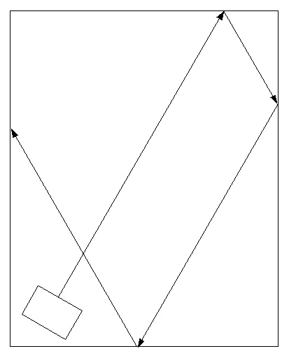

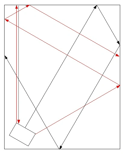

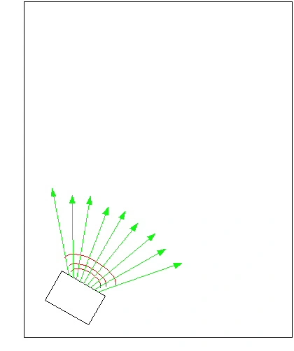

The black line is the fundimental direction, as it will reflect around the room, assuming the speaker cone is absolutely flat (i.e., not a cone) and doesn't deform in any way while it moves.
Since speaker cones are actually cones (and why we call them speaker cones!), there are more lines to be drawn. I've added two red "perimeter lines" and drew the associated reflections for those as well. I've made an assumption here, do you see it? Yes, I've made an assumption that the speaker cone is in fact a cone, and has consistant non deforming sides that are at a constant angle. With these assumptions, you can see the potential for standing waves vertically up and down the left side of the diagram. To be a standing wave, the wave has to amplify itself by overlapping itself perfectly. This is difficult to achieve mathematically, because its possible to have a standing wave between the back wall and the speaker edge, where it overlaps itself, but once the wave comes back and hits the front wall (bottom of diagram), its not going to be in phase on its next reflection, more than likely. You can move the speaker up or down vertically to align the new audio waves with the reflected audio waves, and it would have to be fairly perfect to work.
