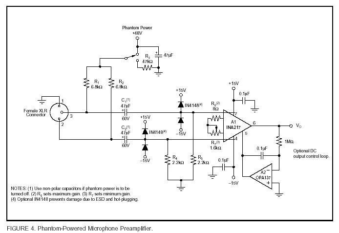

You ordered the same chip - just in 2 different packages. The one you have is the guts for a mic pre - now comes the part where you have to round up the other parts, make a printed circuit board (or direct wire it), get a box to put it in and knobs, switches, connectors etc. This is not a thing you want to do if you've never built a project from scratch.
Attached is the mic pre schematic from the 1na217 spec sheet. As you can see, you need another op amp (OPA137), various capacitors, resistors and diodes, switch, potentiometer and connectors, and+/- 15V and+48V regulated power supplies.
Unfortunately, getting the IC op amp chip was the least of your worries. You really need to buy a kit if you've never done this before.

And I would add that this circuit very possibly has never been actually built, tested and used physically - only designed and tested by some EE at TI with software, and in fact may be found to have problems in actual use, so there is no guarantee it would even work correctly if you did build it.
I read somewhere (forgot where?) that using the servo as shown really screws up the sound. It's way better to loose the servo and just use an ele cap or some metal films in parallel.
