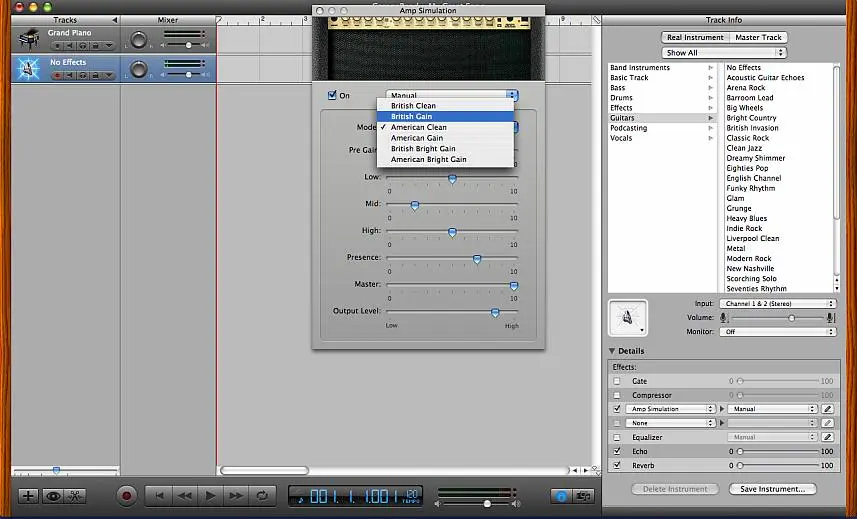

To get to the amp simulation in GarageBand:
  • Create a new "real" instrument track
  • on the right side, under "track info" at the bottom click on "details"
  • from the dropdown menu under "compressor" choose "amp simulation" or "bass amp"
  • click on the pencil icon to the right of the dropdown to get to the editor.
I'm not sure about monitoring through GarageBand, there may be a considerable amount of latency (depends on your interface). Still worth a try.
