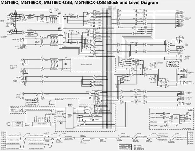

i'm new to mixing - i can read schematics for (and have built) electronic gear but the diagram for my yamaha mg166cx is "connection heavy" (16 inputs, 6 buses) and "function starved" (relative to a premplifier, say). so it's TOUGH on the eyes - plus, i haven't been able to draw direct connect between every switch on the board and every one in the diagram - yet. gettin closer tho.
and yeah - since the keyboard guy has the space HE has the mixer (and most of the instruments) - and i don't get to go back-and-forth between diagram and mixer.

The block dia and the zoom tool is your friend for mixers like that. That and a few prints and a highlighter perhaps to trace through a few the various path and pet trick options!
