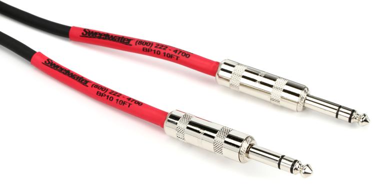

I am purchasing a Rode nt1a. I have an Alesis usb multimix 6 usb interface. I was wondering if I could connect my Rode to a ART TubeMP and then connect that to my interface. If so please tell how this could be done. Thank you!
You can use a trs->trs cable to connect the line level output from the ART to anyone of the line level inputs on the Alesis.
I couldn't see if the ART's output is balanced (TRS connector), but the Alesis's line inputs do not seem to be, they are TS. Should be ok, though.
Yep. You're correct the proper cable should be a TS->TS
