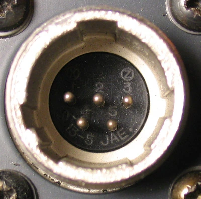

Side note: It's exactly the same connector, though gender-opposite, as on my late 80's, English-made Soundcraft 200B. Same pin arrangement and keys around the inside of the barrel (which is threaded and quite secure).
Maybe you'll get lucky and find some info inside chassis... well, probably not. Good luck.
That connector is neither a 5-pin DIN nor 5-pin mini-DIN. The pin layout is completely wrong. This has three across followed by two across. With a 5-pin din, the pins are either arranged in an arc (two variants of this exist) or in a square with the fifth pin in the center. A 5-pin mini-DIN... well, it looks like this:

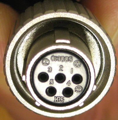

Found the connector by enlarging photos of the connector on my Soundcraft.
Two manufacturers:
JAE
Hirose
Can still find the connectors on JAE's site. Can't make a URL to take you to the page, but here's what you need to find it:
http://jae-connector.com/en/type_en.cfm
- Click under Type Search, I/O Circular
- Under Mating Combination, Choose Type 1, select 5 pins
- Click the SRCN Series link at the bottom
- under the photo, click Product List/Drawing
You get 6 hits yielding both genders for the chassis and for the plug.
The part numbers are:
SRCN2A13-5P
SRCN2A13-5PX
SRCN2A13-5S
SRCN6A13-5P
SRCN6A13-5S
SRCN6A13-5SX
I don't connect and disconnect mine at all regularly, but it's a solid connector with a sleeve that threads onto the chassis-side's barrel.

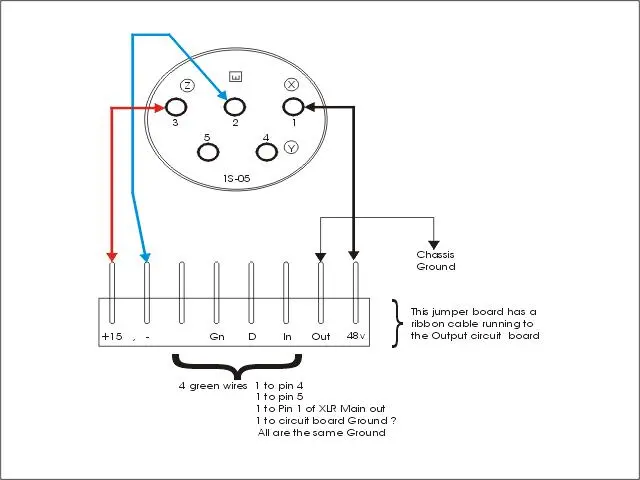

I have opened up the board (very nice modular design)
Found some Interesting info. I do better with pictures, so here is a diagram of what I found. Hope this isn't too big.......
Let me know if this info gives you more insight.
I will follow your current advice on calculating Amperage requirements, If I can.....
The ground scheme seems normal to me--all pin 1s terminated straight to ground, the analog ground on the board terminated separately.
All that remains now is to count the opamps and determine their current requirement. I'm going to guess you'll need 2A on each rail, which unfortunately will exclude the kits from JLM or Fivefish . . . maybe somebody knows of something else out there so you don't have to build from scratch . . .
mshilarious, I would vote for Over engineering....2-amp. Since I don't know the difference from an op-amp and any other IC. I am shure that you are getting tired of talking to "Brain Stems" like me whom, after reading these forums for months, still don't know as much as you have forgotten. Having to educate anybody before you can advise them, must drive you crazy. (comment required)
The board is very easy to access. Each of the 24 channel inputs(I don't know what you call it)...is just a 2 screw removal(1-top, 1-Bottom). The entire output section is removable with just 4 screws. The Whole Back section (Inputs and out puts) is very easy to access. Not alot of cable to pull them out far. Everything is "Hand solderd. No Korean on the cuircuit boards, all english. (I couldn't believe it)
Any ways, where do we go from here? We have the pin-out on the Power Supply connector. (we can certainly change the connector) Lets assume that +/-15 @2 amp and +/-48 @ 2 amp is OK? Now we have to educate adwaz on powersupply design.
