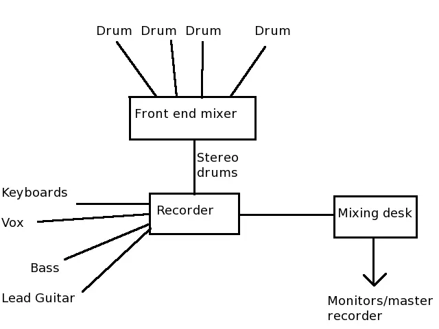

With 8 tracks, one technique is to sub-mix them. That way you can use the head mixer to EQ the bass drum differently to the rest of the kit. That would probably suffice. I guess I'm a little sensitive to this because I had that problem with the first couple of albums I did :P
By submixing do you mean using one channel per drum? As we're recording guitars, bass, drums and sometimes a synth live to keep the whole thing spontanious and loose it leaves us with three channels for drums - then we can EQ and compress the bass drum during mixdown. We could possibly use more channels but it depends how bad the generation loss will be if the process is: 8-tracks recorded live - bouncing to two tracks on a 4-track, adding vocals and whatever and then mixing down to either a stereo tape recorder or DAW.
I mean putting a mixer between the drums and the recorder. Mic each drum (or a group of drums), feed them into a mixer, pan them appropriately, add eq to the bass drum, and then feed that to two tracks of the tape deck. Record keys, vocals, guitar etc to the other tracks as appropriate.
I've put together a crappy diagram, see attached

Submixing diagram:
I mean putting a mixer between the drums and the recorder. Mic each drum (or a group of drums), feed them into a mixer, pan them appropriately, add eq to the bass drum, and then feed that to two tracks of the tape deck. Record keys, vocals, guitar etc to the other tracks as appropriate."
The diagram wasn't crappy, it made perfect sense.
Ah, so thats submixing - we're doing that already; on the recordings we was sending the drums and the bass to a Behringer desk, panning and EQing a bit on it and sending to channel one and two on the recorder. On the next album we'll have an 8-track and the bass will have its own seperate channel which should give more oppurtunities for EQing the drums during mixdown. But yeah, we should probably have added more bass to the kick drum in the first place.
