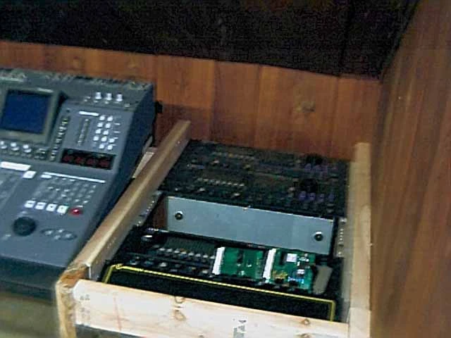

Right-side Recorder Rack.
This horizontal rack houses (2) Akai DR16's, (2) Akai DR8's, an Alesis RA-100 monitor amp, as well as a few other trinkets.

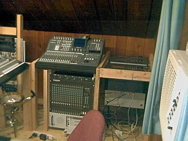

Producer's Desk.
Well, its not really a desk, there is no place to lean on to write :) However, the recorder rack is to the right (see above post), the Tascam TMD-4000 for recording/mixing to the recorders. Underneath is an OZ HR-4 headphone amp for handling performer mixes, a Samson MPL2242 analog mixer for foldback purposes (bus 1/2 is the performer mix, 3/4 is the Cue mix, and L/R is the sum of all four busses for the console table. Underneath that is my super-flaky MIDI composing PC.
Behind the mixer, sitting on the computer (which you can't see) is close to 108 gig of audio storage for the Akai recorders.

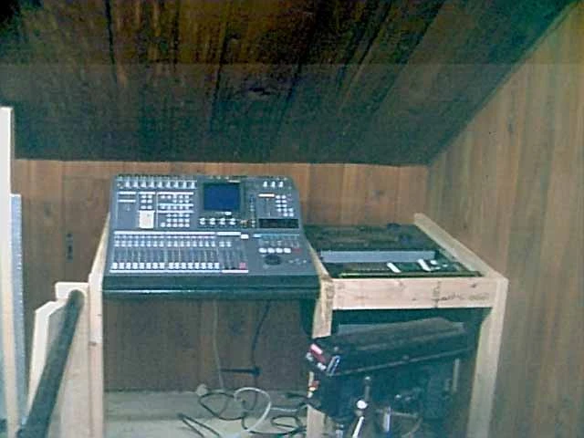

Here is another picture of the producer's area, unloaded with all the gear (in fact, the rack rails are not mounted yet), so the 2x4 construction is fairly obvious. The back bar underneath the Tascam TMD-4000 mixer is nothing more than "ordinary" black pipe normally used for natural gas lines in homes. Its a strong, very inexpensive way to mount tascam mixers because they have this nice arc'd lip they call a "palm rest". Just made construction incredibly easy.
And yes, all the 2x4's will be painted at some point.

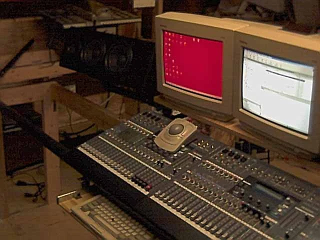

This is the view of the homemade console table, partially loaded. The table is 105" wide and has six Tascam TMD-1000 mixers resting on another black pipe, as the smaller mixers also have this palm rest lip thing.
Ignore the ash tray, I will not admit I smoked in my studio while I was building this stuff :)
Two monitors for the MIDI PC, which also connect to a large KVM switch so I can hot-key the keyboard/mouse/monitors to the Akai DR8/16 recorders, thus able to edit the audio inside the machines, and not task my MIDI PC with this responsibility. The monitors are about to be replaced with NEC 17" LCD monitors that have a slightly higher resolution, weigh less, and produce less noise in the audio system.
Right behind the audio monitor in the picture, are the remains of my midi racks. I originally had six of these, down to four. After everything is wired on the console area (with Mogomi!) these racks will be ripped apart, moved forward a little bit to line up with the back edge of the console table for a cleaner look, and allow me to double up the height a bit so I can cram in more gear. Since the ceiling is slanted, this is a very good use for this space. Plus, there will be a small crawl space behind it so I can wire it :)

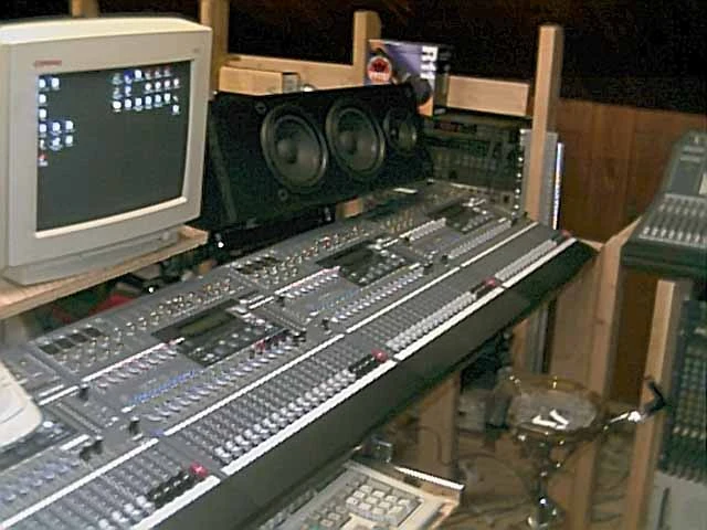

This is the left-hand side of the console table. I took two of the Tascam TMD-1000 mixer's out of the table so you'all can see how easy this table was to construct.
Far in the background is my old console "hutch" which wasn't big enough and about to become scrap, re-used for the midi racks I mentioned earlier.
Also ignore the left video monitor - it decided to burn up and go "red" which is why I'm replacing both of them.
Well, to those interested in how I'm constructing my studio on the cheap, there you go. 2x4's and black pipe. Total cost was about 100 bucks including the pipe, wood, fasteners, brackets to the floor. The only additional cost there could have been was the rack rails that I cut up out of a few old aluminum computer racks I didn't need anymore. I used to be an ISP so I had a few of these things lying around. Made for good cutting :)
In most of the pictures you can see some sort of seemingly ugly paneling. This paneling is tongue and groove cedar believe it or not... about an inch thick. This was there when I moved in last may. I yanked it all down, put behind it better insulation, a layer of greenboard (sheet rock for showers), a layer of thin plastic, another thin layer of greenboard, a layer of 1/8" rubber, and then tacked the tonge and groove cedar back. On top of this I will paint with "superwhite" latex paint, and on top of that will be 2'x2' auralex acoustical tiles, seperated by about 4-6" depending where in the room the tiles are.
The room is absolutely not ideal, but I've mixed in significantly worse environments before, so once my ears are trained for this environment, I'll be okay.
