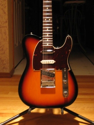

The other reason is that in 1948 when the first Tele was built, they probably thought they were being generous adding a second pickup. Since then, they haven't messed too much with it though....why mess with a classic sound. Recently though, they put out the Nashville Power Tele, in which they managed to "squeeze" a third pickup in there.
