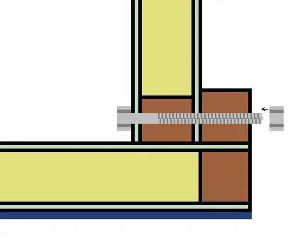

Just had the idea to extend the floor and then attach the walls to the floor with a nut bolt, like below. What do you guys think? Will it work? What if the wood/plywood expanded?

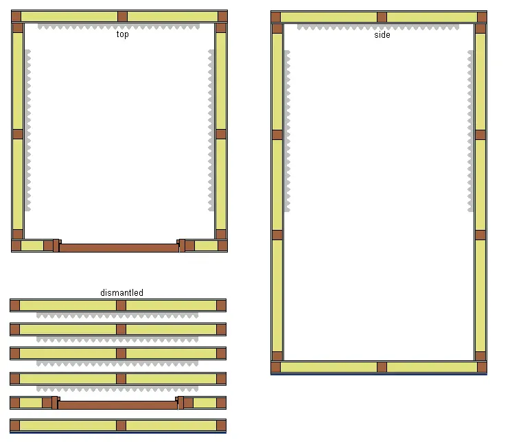

I don't think my last post worked, so I scrapped the idea of the dovetail because with time and wear and tear, it would need to be made of plastic. I opted for a tongue and groove idea that may or may not be cost/time effective. anyway, here is a terrible drawing of it.
Ah, cool idea! Although, I think it would be quite difficult for an amateur DIY guy, like me, to build. :o

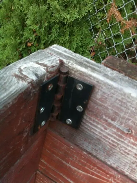

Hinges.
I'll try and post a pic of how to do it.
