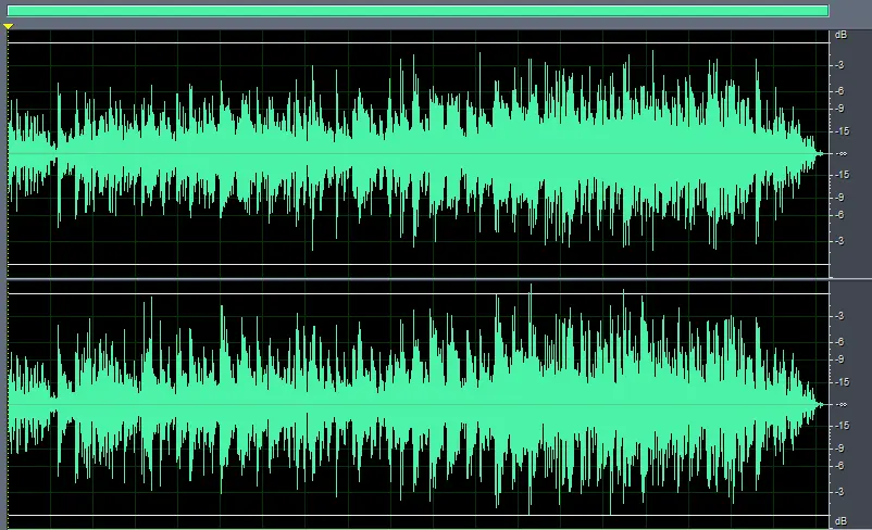

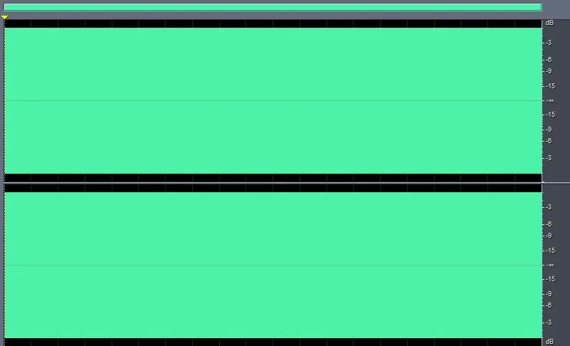

ihave clients with help needed in song. i compress the mix but there is distortion of some sorts?
i dont know what a problem could be? i read tutorial on loud mixes but maybe the advice is not correct?
pls see attached images of work. i do not want to lose job :( :( :( :(

can someone pls look at before wave and give estimate of starting value for compression for max loudness????????

Your after picture shows a waveform that is commonly called "toothpaste", or "crew cut". Way, way, way too much compression and makeup gain. Adjust the threshold so that less of the signal is getting compressed, and then don't turn the makeup gain past the point where it starts to distort.

Well if you are i don't suggest squshing like the picture shows.

Run a stat on the waveform found out what the RMS level is then calculate the differance of that number and (this is not an exact number guys/gals but I use -12dbfs most of the time) then raise the volume using a compressor or limiter or normalizer by that number.
Yes this is the wrong way to do it but the volume will be louder and the waveform hopefully will be a lot less squashed. If they want more than that make them send it to a mastering engineer.
