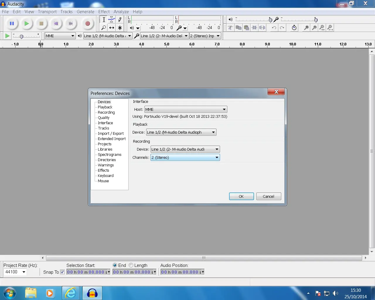

Are you sure you have Audacity setup for stereo recording as shown?
There is an option to have mono!
If this does not sort it see if you can try the interface on another PC.

Hi Dave, thanks for replying. I've tried it on both mono and stereo on Audacity and neither work. I've also tried it on another laptop and had exactly the same problem - it all works perfectly for the mic input but not the instrument input.

Changing the default format on the laptop's control panel from 1 to 2 channels seems to have fixed it! It's recording on Audacity now.
