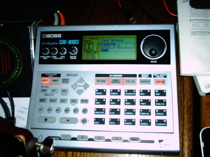

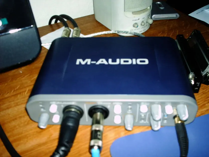

The red and white chords coming out from behind my DR-880 are coming out of the "Master out" port and they are going into the USB interface via a 1/4 inch jack. When I put that jack into my amp, the sound is awesome. Only when I try to run it into my recording port on the USB interface do I get all the hissing and really bad sound quality. The other jack going into the USB interface is my mic chord. No problem there. Great sound through the USB interface, but it doesn't go through the DR-880. Hope the pics help you help me. I am recording with Acid Pro 7. Is there maybe a setting in there I can tweak?

I thought from his opener that he owned the Fast Track USB but that picture looks like the Fast Track Pro, in which case the problem is with the set up.
It's an excellent unit.
I think you're doing too much there.
Can you actually use 4 ins with the Fast Track Pro simultaneously?
I thought it was an either/or thing.
Mics, lines or SPDIF.
Also, I see your PAD switches are out. Try using them and make sure your not running lines into your "Insert" ports.

If I'm seeing that right, you've got a Y-cable with two RCA connectors on one end and a TRS connector on the other.
This is trying to send a pair of signals - stereo unbalanced ones - into a mono balanced jack.
I'm not 100% certain, but I think this might be your problem.
Try either:
getting just a normal 1/4" to 1/4" cable (like a guitar cable) and taking it from the master out (mono) on the back of your drum machine (it's the one just below the rca outs you're using now, on the right if you're facing the back of the drum machine) to the same input you're using.
OR
getting two 1/4" cables and going from the stereo master outs on the drum machine (the pair just below the ones you are using) and into both inputs of the Fast Track if you want stereo drums.
You only have two inputs on your interface, so you'll have to choose between either stereo drum tracks without a simultaneous mic input or mono drums with a simultaneous mic input. The decision is down to what sounds best to you.

Kudos to Jim Lad and The Cancers! By pushing in my pad buttons and by running separate 1/4 inch cables from my master out into both recording channels on my USB interface, then choosing "Channel 1&2" to record, it works!!!! No more hissing and the sound is great. You guys are awesome. Thanks sooooo much for your expertise and patience in helping me. Let me know if I can give you guys reviews or anything to pump up your ratings. Although, I don't know if it can get any higher than "Force of Nature." :)
