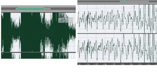

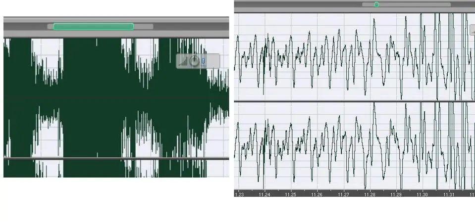

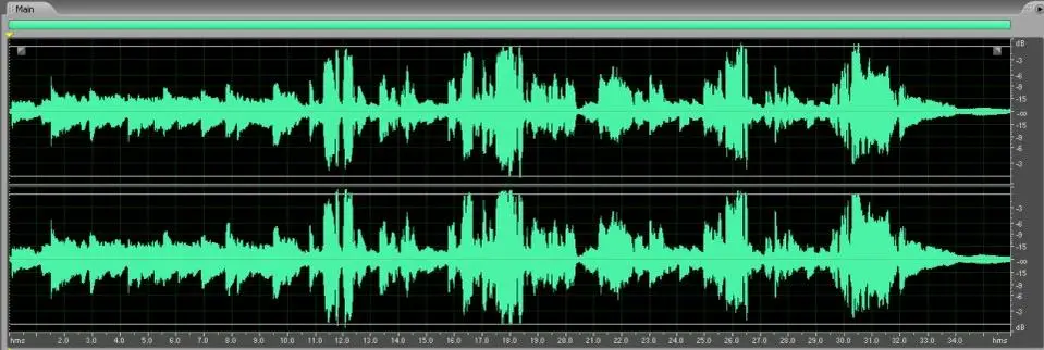

Addressing the waveform appearance
Without seeing it, hard to say for sure
Was not entirely sure whether you were referring to latest transfers from tape or the earlier musical performance and even speculation might be different depending
Included a couple pictures that might or might not point to possibilities
The first one is essentially a pic of a wav of a live vocal guitar performance without any added FX more or less normal dynamics. While this represents only about 30 sec. It's resolution is roughly consistent with what would let me view the entire 3 min. File on my video display. If you zoom in, or out, depending on intent the appearance of the file will change. The 2nd picture is of the same resolution but the audio has been, for me, hyper compressed (I've worked with people who have been know to compress things even more, whose goal would be to make the audio representation look like a brick). At 'normal' visual resolution the top of the file looks flat.
Third pic has two images. Same Audio this time a small sample size. The Audio amplitude was increased beyond the level that could be represented by 16 bit audio you can see waves on the left (of each image) terminate in more or less typical rounded, pointed (sine wave) fashion. As the actual audio exceeds 16 bit 0 dB the wave didn't reach it's peak amplitude before it was truncated . . . The visual is missing the top portion of each wave . . . Flattened, clipped
What the top of the wave form looks like can depend on relationship of visual representation to audio data . . . Higher resolution reveals more detail about the pressure wave, lower resolution visual representation will look more like a simple geometric shape, diamond, rectangle, etc.
These plots are amplitude over time (only one of several ways to visual represent audio, although perhaps the most common, but do not reveal all information. You can plot frequency over time and frequency over amplitude (and I suppose amplitude over frequency though I don't typically use that one) The peaks (top and bottom) are peak amplitude, at various visual representations the 'dynamics', the less compressed the piece the more variety there will be in those peaks, more like mountains, less like northern Kansas. If you are viewing an amplitude over time plot of one hour, it's top will look flatter then same material @ 1 min resolution Very generally speaking a spoken word piece would tend to have less dynamic variety then, for sake of argument, most music, hence more regularity at any resolution for the top (or bottom) of the wave. If by chance the new content on which you are working was intended for broadcast it would be very common to run the material through a compressor. The job of that tool is to even out amplitude; quash high levels then via make up gain increase the lower levels making a visual representation look more like image #2.
Additionally the potential dynamic variation is controlled by the hardware, microphones, amplifiers, recorders, etc. Can all limit potential variety of a visual plot of amplitude over time. A cassette recorder, as a rule, can preserve less variety (has lower headroom) in an audio pressure wave then can any but the cheapest of current analog to digital converters

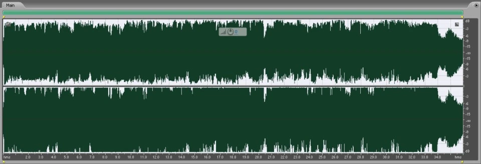

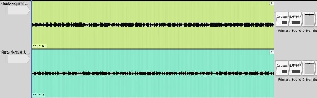

Ok, so, here's a pic of side A and side B of the tape. I didn't adjust the volume; side B is not as clipped off because they are two different people, and the guy on side B had a softer voice. So, doesn't it make sense that it's because the DP is 16 bit? The other problem I have is that whenever I use that digital recorder, then transfer the wav files to a DAW (audacity, Sonar 7XL, or Tracktion 3), they are so tiny! I've asked about it before, somewhere, but now I have a picture to show what I mean!
I tried to test, using my firewire interface, to compare what kind of wav forms I would get, but my laptop crashed twice when I tried to record. We downloaded Reaper last night, and will be trying direct input from my little tape recorder/player through 1/8” out/in to the laptop mic-in.
p.s. Hubby had a theory about why the files are so small from my DP: If I'm recording at 16 bit, and then importing it to 24 bit, it would be exponentially smaller than something that was recorded at 24 bit. So, I'll be testing that theory soon, by importing one of the wav files from the DP into Tracktion at 16 bit (once I figure out how to change that setting!). It's something that has bugged me for some time, and I couldn't figure out what was up. Once he said that today, it seemed so reasonable.
That wave "height" in digital is directly related to the actual signal volume being recorded or edited, and has nothing directly to do with the conversion from 16-bit to 24-bit.
If your signal is coming in that low off of the tape, either the tape was recorded really quietly, or the volume at the input of your A/D converter (computer interface) is set too quiet.
If the waveforms are larger and of more normal "height" in the 16-bit version - i.e. they are recorded to digital OK, but it's only the 24-bit version where they are that tiny, that's not because of the the word length change itself. A 0dBFS (for example) signal in 16-bit will remain at 0dBFS when converted straight to 24-bit; the "height" of the waveform will not change. But if that's what's happening to you, and if we assume that there's no change in the vertical display scale of your timeline display, then the problem probably is that there's a gain/volume control in whatever you're using to make the conversion that's turned down too low.

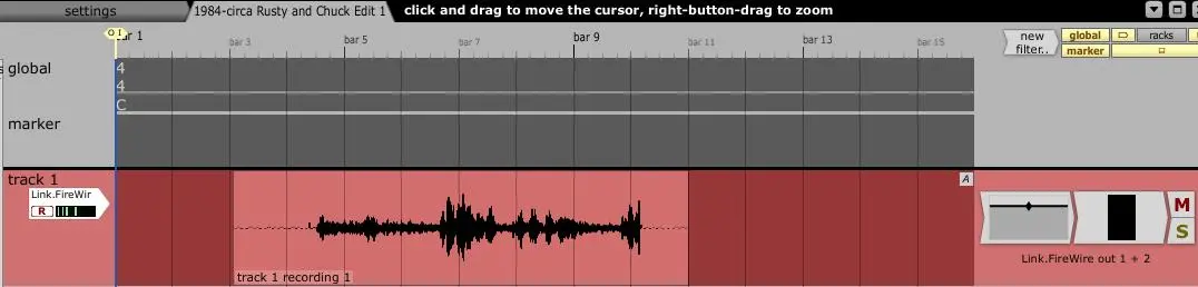

First of all, I figured out how to record directly from my little cassette tape recorder/player to my firewire interface, into my Tracktion 3 (Mackie DAW)! In the picture below, you can see that my problem of the high and low frequencies being chopped off has been solved. This is truly an upgrade for me, since I had several steps I used to go through (for the previous 8 tapes), and then I was working in Audacity, which was ok at the time, but is no comparison to what I'm able to do in Tracktion!
Secondly, I played the mp3 from one of the talks I just finished and my Hubby and my family were very impressed with the results! They noted a major improvement in the sound quality. I think you can see that I used some compression and lo/high pass filters on those tracks (wav picture in previous post). I also needed to increase the gain, and use a volume gain in one of the compression parameters, which you can't see from the picture.
I'm so happy, because I feel like I can successfully complete this project in the near future, and it's not going to be a drudgery at all! I'm so grateful to my dear Hubby for his willingness to provide such nice tools for me to use.
