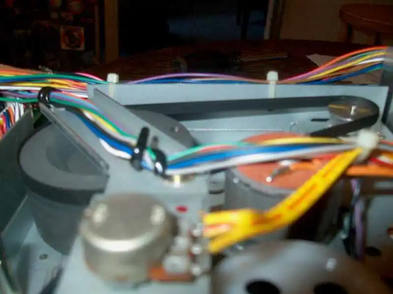

You say you had the 244 serviced recently, but...
If the 244's capstan drive belt becomes stretched, it may drop down and ride on the flange, instead of on the middle of the pulley where it's supposed to be. This change in position and diameter will cause a noticeable speed-up of the tape mechanism. This may or may not be the case, and there may be other issues causing this problem, many of which were covered above.
:spank::eek:;)
