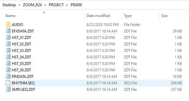

Frankly this seems like a really strange system. By contrast, the Zoom R24 simply creates a folder and dumps raw wave files along with a setup file into the folder.
Here's an example of the Zoom R24 file structure:

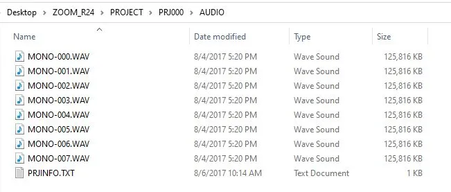

Accessing the audio files is as simple as dragging them to a computer folder and dropping them (which is what I did here).
