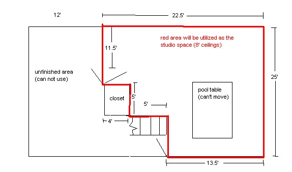

here are the dimensions of the room. I will take some pictures so you can get a better idea.
I guess i should tell you that all the furniture will be gone, except for maybe a couch. The pool table has to stay where it is. I have those 2'x4' 703 panels like i said. I have maybe 10 of them. I have a 8ft wide console station with racks and stuff.
I think i'm going to use that little closet and part of the unfinished part to do guitar overdubs and maybe vox. the drums will be recorded in the room. I'm looking for the best place to put the workstation along with how to place the panels now that the room is so much bigger. There is no possibility of construction as this is my parents house. Although they did offer to put up isolation rooms, but i won't do that since i won't be here that long. this is kinda temporary (a year if that's temporary enough), but i want to make it sound the best it can.
Please help,
Brandon

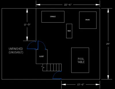

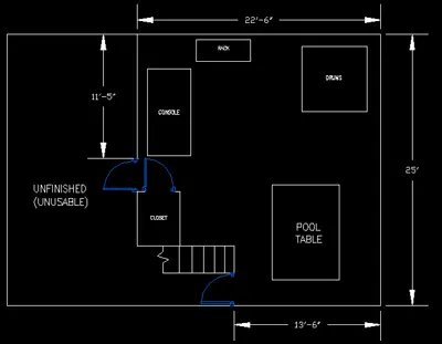

I got to work today and was able to dimension is so it's a little more realistic. I put the console and drums in the two places i thought could work. please let me what you think. I'm hoping to make the move in the next week.
Thanks,
Brandon
Brandon,
The main problem I see with those proposed layouts is the mixing is not symmetrical. You don't want the wall on the left to be a different distance from you than the wall on the right.
--Ethan
