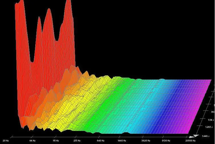

Having some trouble doing a RTA with this "audio dock"....tried like 3 different softwares and wound up only getting this strange 3-d graph?

3) I then loaded this wave sample into WAVE Lite software. At 24/48K
Again I could playback the SSSSSSHHHHHH sample.
By highlighting the waveform and selecting "3-D Spectrum Analysis"
the picture/graph below was obtained.
but there's no DB reading? it has the Frequency range and the right side of the picture is TIME (millseconds)...which has me confused. Is there other software that can give me a normal Freq vs. Db graph from a Wave file?

Just noticed there is no dB reading at all? what settings you have for the waterfall time domain? 1.5 seconds?
Should look more like this:
The time domain is @ 300ms, and no that is not my current set up. I just grabbed the first thing I could find. Thats the before response LOL :D
From that, it tells me that you've got a fairly big problem, at the mic position (which i'm assuming is your mix position), between 60 and 100hz-ish.
You're also getting "ringing" at around 170 and 250hz, and loads of low-end build-up at particularly at 30hz, but also generally in the 20-70hz region.
Hey Thanks MD, but if you actually read underneath the cool looking waterfall plot, you will see that I said its not my current set up. After treatment its been fixed, and the dips are almost gone. The 35 hz area is the onset of the monitors. and from what Iv;e seen, all plots will show the onset as a peak.
Heres the current plot
