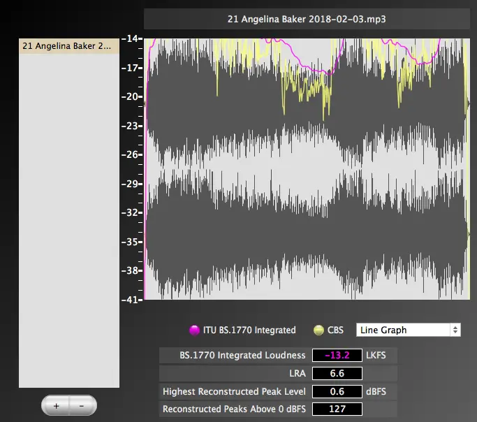

I'd say it's all caused by clipping. Turn the level down considerably, recording 44.1 or 48/24 WAVs. You can add gain back but that MP3 is over the top. (See the "Highest Reconstructed Peak Level" and "Reconstructed Peaks Above 0dBFS" in the attached image.)
Now, if you have original WAV files from the Zoom SD card you can export without MP3 normalization, it might be worth looking at those.
