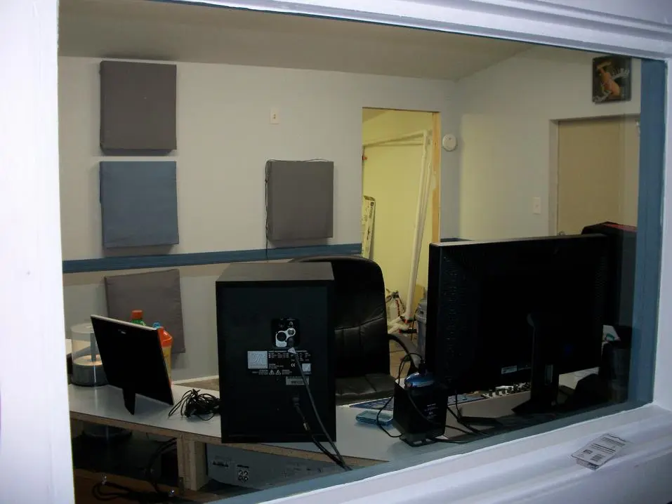

Between me and my uncle, we wired the building the best way we knew how. Look Oshman, I can take a little constructive criticism, but your post is borderline insulting. I do not claim to know electrical wiring do's and dont's, and the reason for the pics was not to show off my obvious lack of electrical engineering skills, but to show how hard we all worked at making my little dream a reality. And yes, it is insured, and in Florida any building less than 500 square feet does not require an electrical permit, so it will be covered in the event my piss poor job at wiring results in an electrical fire. Now back to posting those pics!
Brian probably could have put it a bit more civilly, but he has a point there. You'll want to be *very* sure that your electrical work is sound both for quality audio and for safety. Though I can definitely do my own electrical work, I usually sub that out just to be sure that it'll be done correctly.

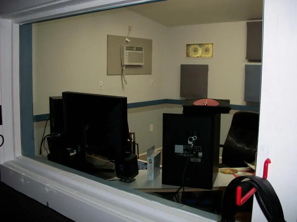

First, your studio looks very nice. Love the color scheme. I'm glad to see you put in plenty of electrical outlets. And at a more user friendly height. One of my pet peeves is never having enough outlets. Why do/did people build and put so few outlets in a room? I live in a very old house and hate the fact that there are so few outlets in the entire house!
Questions: Just out of curiosity, what's the reason for the exhaust fan?
The hole around the air conditioner is somewhat larger than the unit, what was your reasoning for that? I like how you finished it, by the way!
The video monitor above the piano, how is that used? is it hooked up to the computer?

Thanks Joel, I am glad you like it! To answer your questions, the "exhaust" fan blows cool air into my PC and Network room. Not ultra efficient by any means, but it works.
The monitor in the recording booth above the piano is so I can monitor and control the mix while I record myself. It is simply a clone of what is going on at my recording desktop. It keeps me from having to get up and go to the mixing desk every time I make a booboo! I learned this the hard way when recording lots of acoustic guitar tracks. I use a wireless mouse and keyboard to achieve this. It works great, and I love it! As far as the rain is concerned, I can only hear it when it pours- and that is a blessing. The only thing my booth lacks is a solid core door to completely block all noise from the control room.

I do like the sound of the control room. Of course, it is smaller than I should have made it. I wish I'd extended it out about 4 more feet, making it a 10 x 16 room, and thus making the control room a little smaller and not a near perfect box which is what it is now. It is nice and quiet though, and like I said before you can only hear it rain when it is *really* coming down...

Who did the hack electrical work? No staples on the boxes, no connectors on the branch circuits at the service, no separate neutral and ground bar for sub panel. Neutral and ground cannot be bonded at a sub panel. Is that romex inside pipe as a service feeder?
Did you use wire nuts on the grounds in the outlet boxes? Are all metal boxes grounded? Did you install a ground rod outside the building? Did you bond the structure? (since it is a metal building) No use of nail plates on any of the drilled studs.
Looks like more than 8 outlet boxes per circuit too. That is a lot of outlets for only two 20 amp home runs.
I hope your fire insurance is paid up but they won't cover work like that.
The rest is cool though.
