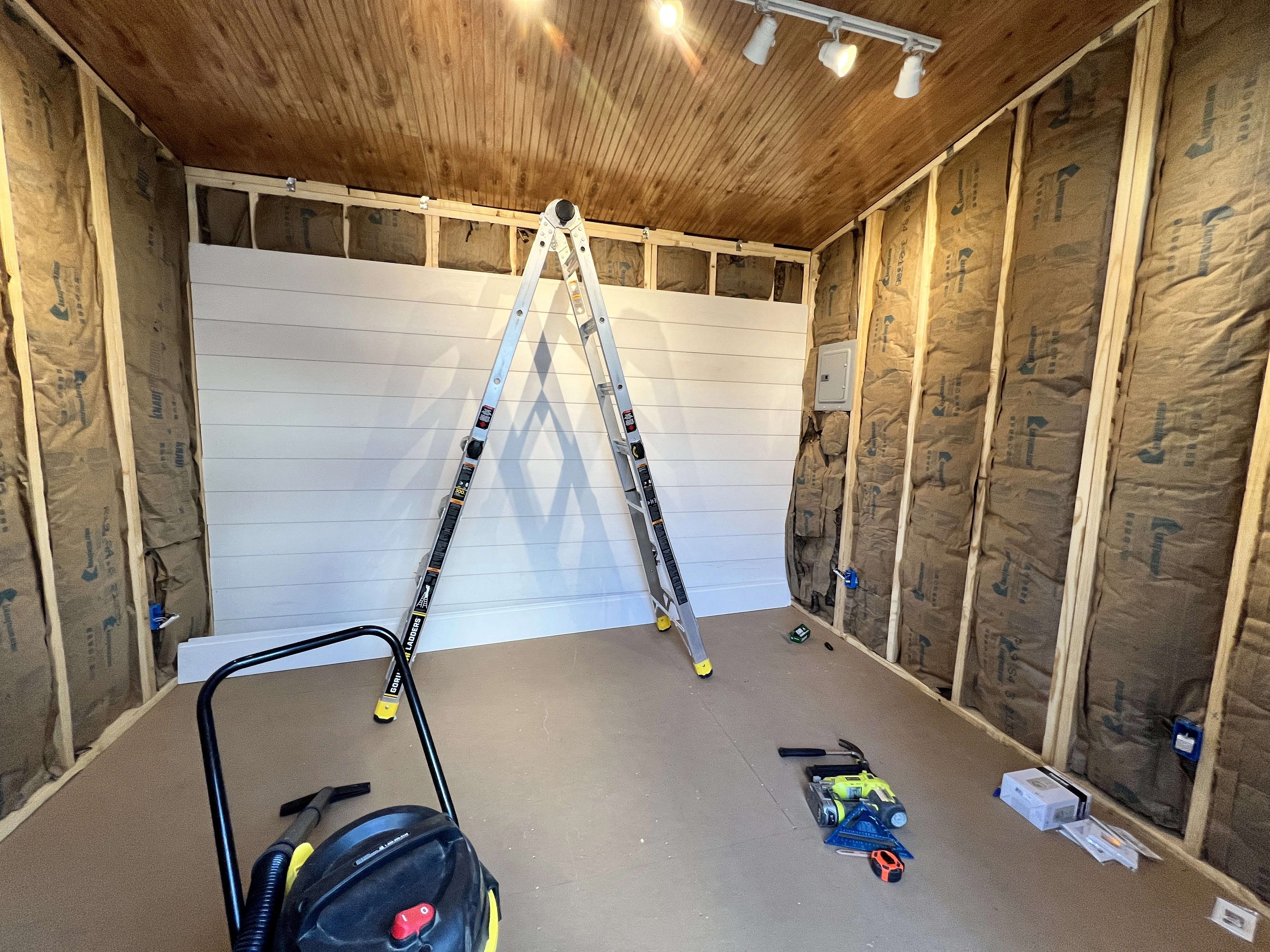

So I started this project last April when I ordered a 10x12’ building to finish out into a studio in our backyard. In august the company had failed for over a month to deliver it, and refunded my money. I ordered a building from EZPortableBuildings out of Kentucky. It was delivered in November. Electric finally went in January and the past few days we got the insulation, ceiling and lighting in. Next the walls go up, Mini Split HVAC and floor. Can’t wait to get it wired up. I’ll continue posting pics as I get it completed.

You should put a vapour barrier over the insulation and studding before you put up that internal cladding, because condensation will collect there. Also why have you doubled up on the timber uprights in places?

Down here in the south, it’s not recommended as much. The paper backing acts as a vapor barrier. We own 7 cottages and 4 motel rooms and know our climate pretty well. This studio will always have hvac running to keep it temperate year round and dehumidify/humidify as needed.

Thats ok do what you want but to correct you a little.
The vapour barrier is not to protect the insulation which the paper backing is wrapped around as you refer.
Vapour barriers were a requirement to install because it was found on timber frame buildings that water vapour most probably through condensation will get through cracks and around electrical fittings and collect on cold spots usually around timber joints and then rot the timbers. Nothing to do with insulation.
On the point of your hvac. Do you know how to make a silencer that works for your studio that works? You will need two......One in and one out.
Or are they not required?

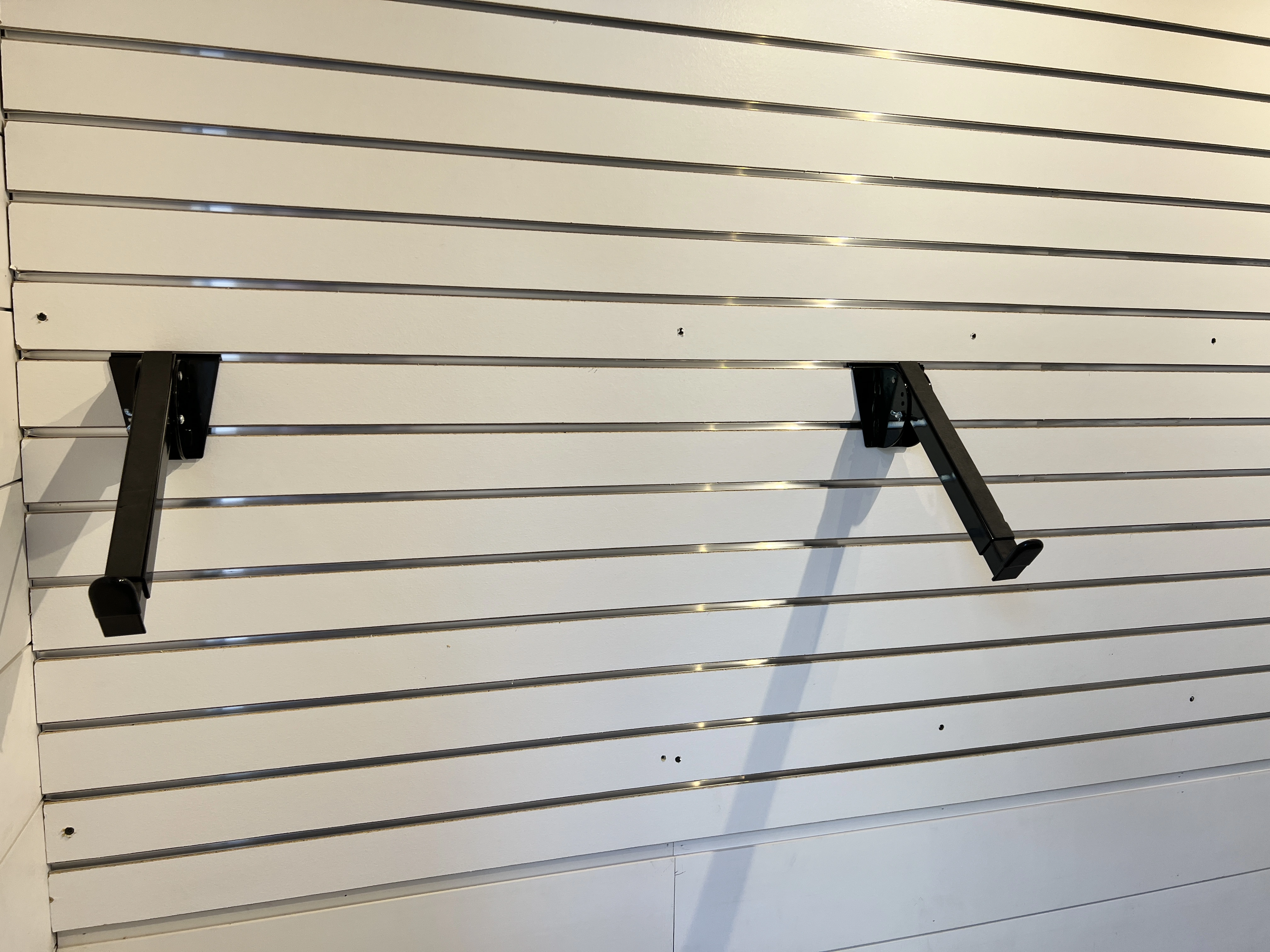

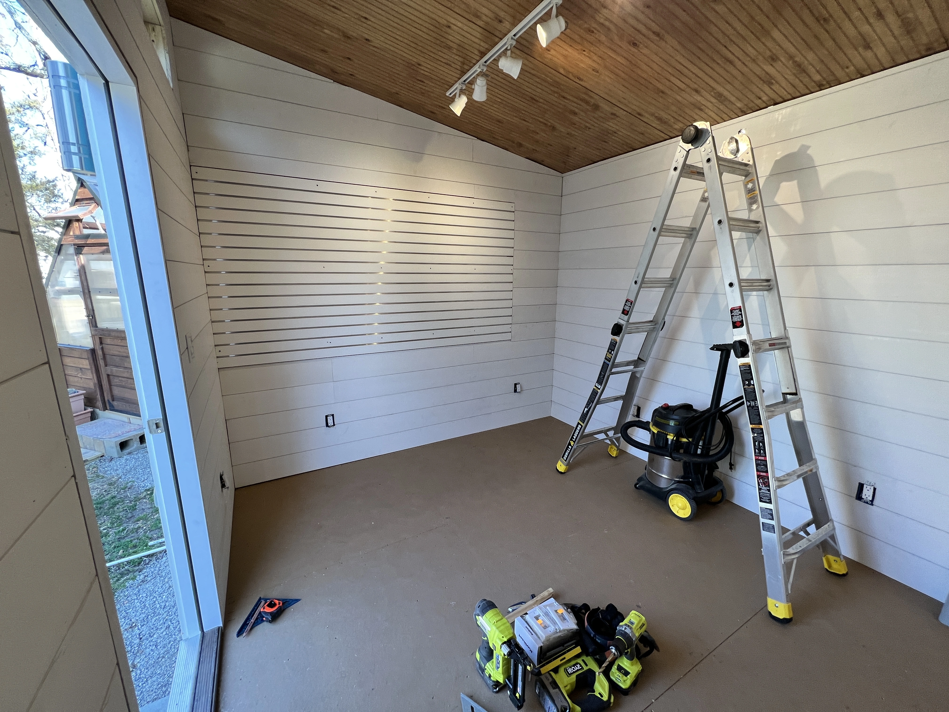

Walls finished, slat wall up. Next is trim work, paint, HVAC install and floor. I’ve got 8 sets of the keyboard arms for synths to hang on the wall. Got a good echo going on in there so I’ll likely be adding some kind of treatments. I have several bass traps and a cloud above mixer already, but I’m thinking the corners might need a little help. As I learned at my recent tape camp session in Nashville, it’s best to get everything in there before treating and since I’m not looking for a dead room, I might be pleasantly surprised with what I get!
