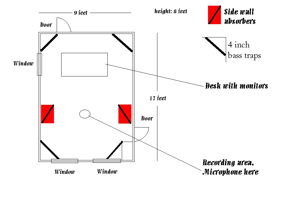

My room is 17 by 9 feet…has 2 doors…has 3 windows…the ceiling is 8 feet high…
As you can see I in the pics below that I have already put up the bass traps and one cloud…
This is what I want to do now…
Side walls
More clouds above the recording area, my mic will be in the middle of the room…a little closer to the back of the room though
Anything else that’s missing
I followed this site http://www.hp-h.com/p/hapicmpur/homespunStudio.htm for the bass traps and clouds instructions…
My clouds are 2 inches thick and are about 7 inches away from the ceiling…
My bass traps are 4 inches thick and are put up to the wall…except the bottom one is a little bit farther…

ok so i want to make a list of stuff that has to be done still
judging by the pics
1. More clouds (im guessing ill put 2 more close to eachother, over the recording area) ...including the one thats already up, i will have 3 on the ceiling...2 inch thick...
2. 2 Slot resonators *as suggested* ( one on each side of the big side walls i have on the pics)
3. The floor i will leave as carpet, but I will have a huge peice of plywood that I will lay down when recording acoustic guitar etc.
4. Absorbers all around the room's walls...
Is this really it?
You guys, please tell me what else I would need to have up, so i can calculate how many of the things i need so i can calculate my prices...
I dont get it, the absorbers on
and the absorber explination on some other pages states that it should and is better to have it away from the wall...hanging etc...
should i still have absorbers around too while having the slot resonators...
anyways, please tell me what else you would apply to the room i have made so far...and is it done right so far
thx

Everything looks good so far. You want to have both broadband absorbers (what you have now) AND the slot resonators to even out the roomd without making it TOO dead.
You DON'T need to leave room behind the slot resonator at all, push it right up against the wall. If you want to lower the absorbing freq of the resonator you can make the cavity DEEPER inside.
ok i did not mention the clouds because those are pretty basic...
i didnt draw them in...
can u please tell me if this is the right place where i should put the side wall absorbers...i drew them in with the red and black line...
also, i dont understand...in the John page...they always have 2 slanted boxes described as 1 absorber...
is 1 absorber with 2 slants (meaning more wood and resources)
or is it just 1...
show me where I should place my side wall absorbers...I have recording and monitring in the same room as you can see by the pics...
should i have 2 more with the along the sides of the desk?

This counts as one.
Your goal is to break up the parallel walls at the mix area and the tracking area. So if it was me, in a room that small, I would put them everywhere I could fit them.

budget is a factor here too...if i could put as much of everything everywhere, id just do that
but i want something that will do that work at a minimum
i have my bass traps up...as you can see....cloud....soon more clouds
so if those 2 slants are considered 1....then i will put 1 on each side of monitoring and recording....

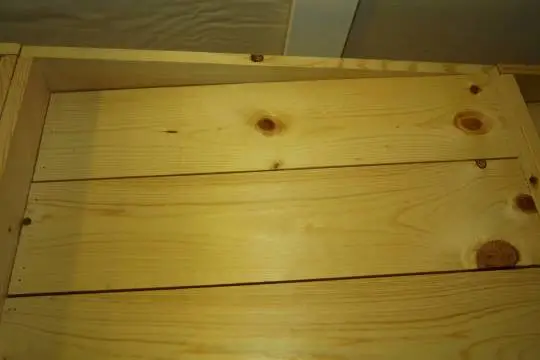

Ok, I stated right there...MDF FRAME AND PINE SLATS.
I'm not trying to be rude, but you have every piece of info you need and you're asking the same questions over and over as if you're expecting one of us to come along and say "I have a way you can make that room sound like a pro studio for 25 dollars". Well, that just isn't the case.
As far as step by step instructions....you've lost me, the picture that's been posted in this thread four times is so detailed it's not funny. If you have no experience building things, show someone who has and they'll get it right away.
