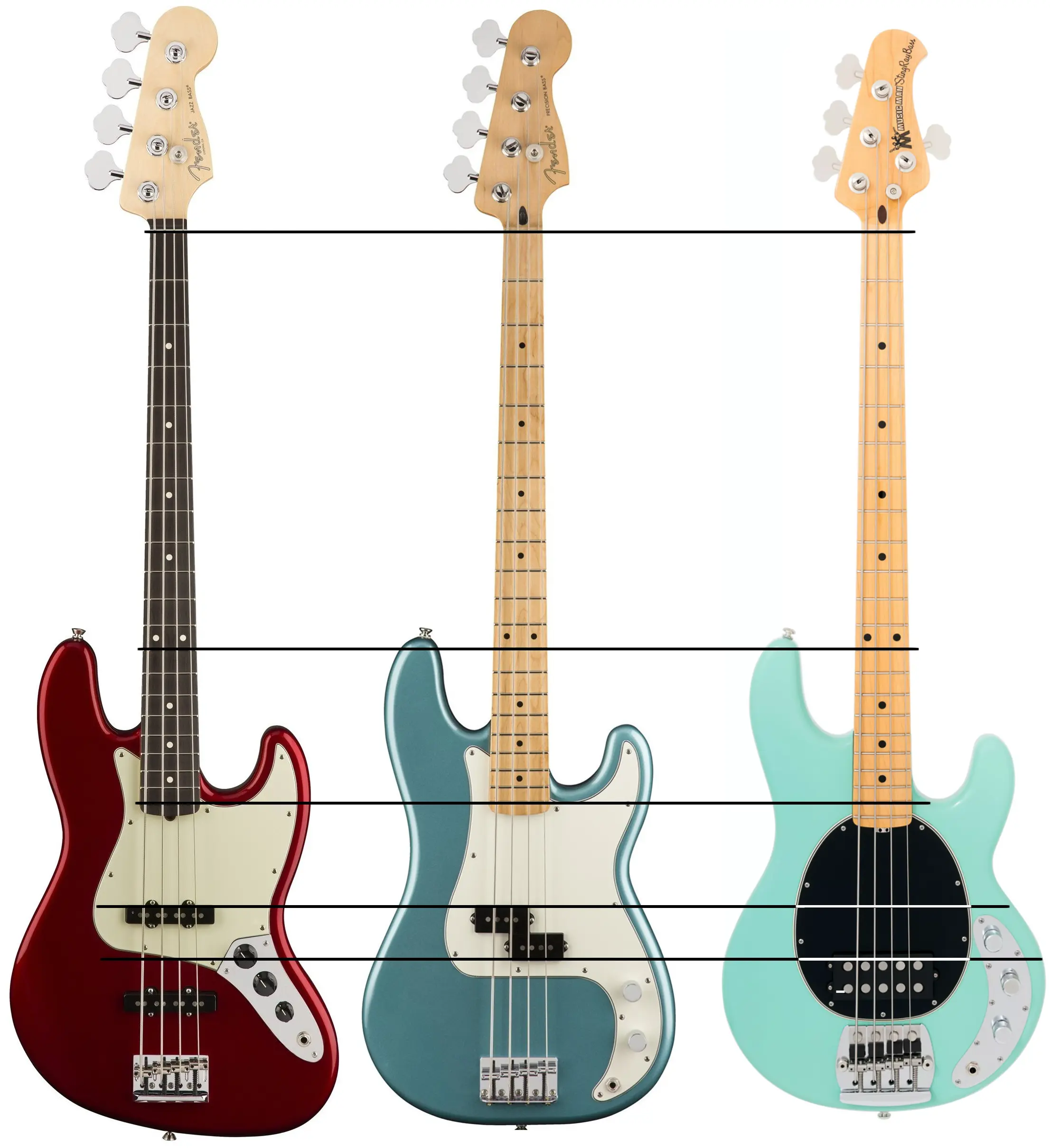

This is a helpful image, and I think this stuff is pretty thoroughly studied on bass forums. Comparing youtube audio reviews/demos should help you a lot, G&L specifically has similar models of basses that vary across the three 'regular' pickup placements.
