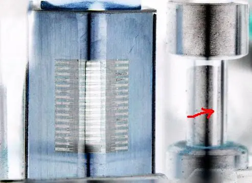

This probably does more to expose the shortcomings of a photo for judging head wear.
From what I can tell it appears to be a very low-mileage tape path. The only problems I see are the tape oxide buildup, especially on the guides, and some more persistent contamination on individual tracks. Whether these are remnants of sticky tape or surface oxidation, I can’t tell.
The wear pattern appears reasonably narrow on the head itself as seen in this negative pic. More telling is the minimal wear on the tape guide to the right of the head – not as obscured by glare from the photo.
Many older machines need an application of non-abrasive metal polish to tackle surface buildup that alcohol won’t fix.
