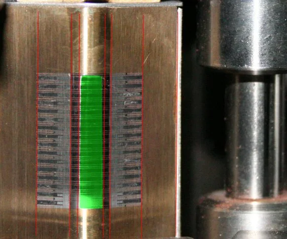

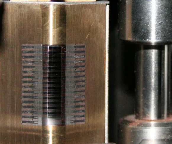

dfgh11 said:
Ok, here are some pictures. I took quite a few so if you need any more let me know.
picture 1
Picture 2

here one of those shots' cut
(resampled 50% and a bit compressed to be under 64k)
Ok, the links are working now but thanks Doc for posting the one clear pict. :)
here's a shot from "investigative report"
... I mean ...expertise...;) :D

I may need a slight amount of help here. What are we looking at specificaly?
btw, seriously...imho, you have to be very careful if/when concluding anything 'for sure' based on viewing a digital photo ... you do not really see the depth, and you do not really see "the axis location", plus a bit of perspective effect kiks in and other illusive artifacts... I guess it is sort of possible from evaluating series of photos made from different angle... still, you know
I personally see no obvious head wear but then again .. what the f*ck do I know! ;)
The center "green" indicated area in the original photo looks darker and may show a flat spot or may not, depending if this is a lighting related issue or not ... It's def hard to see one way or another .. (at least for me :o )
Yeah, sort of ... really hard to tell.
Also, Daniel... sorry for any confusions (if any) with that second picture... I should of make a note or something. I've "painted" the suspicious area and added "vertical" lines to sort of see if it may look like uneven wear (if it is wear.., well, it kind of looks like it is, but hard to tell how bad it is... if it is what it looks like .. arghhhhhhhhhh :o
No problem as I was looking at the first one you posted (sans the "retouching" ;) ). I was just pointing to where I was looking at. ;)
I'll commit:...
I think it's pretty extensive head wear. :eek:
