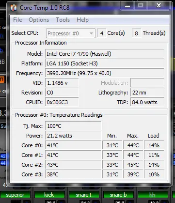

Looks similar to the basics of my current setup.
Take to heart Tadpui's post about the i7 4790 running hot. The stock fan was not adequate in my experience. $30 for a Coolermaster EVO if your case will fit it. THIS worked wonders for me.
I hit thermal shutdown once during a session without the added fan on just a simple 60 or so track audio project. Nothing out of the ordinary on a recording only PC. 90 degrees plus with stress test on stock CPU fan. less than 60 with the EVO cooler.
