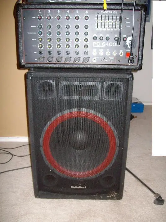

I'm confused. I have slapped together a misfit ROSS PA, a 400watt mixer/head unit to a speaker cabinet, Radio Shack 15"/horn.
It is vocals only.
Problem- the volume isn't there at all?
is it the head or speaker? seems 400watts should be more than enough?
the mic is a standard 58 ripoff...copy.
I'm leaning to the speaker, will a speaker change increase the volume?
here's a pic

SM58's are low impedance, so you need to use an XLR to XLR cable for it. I hope you're doing that and not using a XLR to 1/4" cable.
Try plugging another source (electric guitar) into it to see if that's the same.
er....oops...got a xlr to 1/4".....

that cable seemed to have quadrupled the volume!!!
wow?
i'm in shock at the difference. of course now I can't barely turn the amplifier up with out feed back....but I'll work on that.
thanks so much! so the amplifier is cool. probably try to upgrade the speakers with some trading...and cash.
thats amazing..just ran a comparison test to show this, and the 1/4 mic cable had the power amp on full blast....with the XLR on both ends, the amp is at 25% its squealing...with eq up to 40% in this small room its loud!!....wow.
When you plug into the XLR jack on your pa it goes through some additional electronics that boost the volume that the 1/4" jack doesn't have. It isn't just two jacks that are the same.

A more detailed explanation, Coolcat, is that the XLR connection goes to a pre-amp first, then to the power amp, also inside the PA head. The pre-amp boost the signal to a level the power amp can better use. The "line" input is for devices like a keyboard or CD player that puts out a stronger signal than most microphones do. There's more to it than that, but that covers the basics.

That Radio Shack speaker with three piezo tweeters has the potential to clear a room real fast! :eek:
The woofer probably isn't half bad. Companies use piezo tweeters because they require no crossover, so it makes a cheap setup. We used to stuff black socks in piezo tweeters as usually speakers with them have way too much treble compared to bass.
I had some Peavey 12" + piezo tweeter speakers that were much better after I installed Radio Shack speaker volume pots on the tweeters so I could run them at maybe 1/3 the output they ran at normally.
