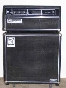

AMPEG SVT15E 1X15 300watt $200..... I think I'll go pickup the SVT and try it for a few days.
any inputs appreciated....
Updated- got a USED Ampeg SVT 350H head $199 (made in US) and 1x15" SVT15E cabinet $200 GC
30 day trial.:)
off to make some cables....and figure out how we can pay it off in 15 months no %..

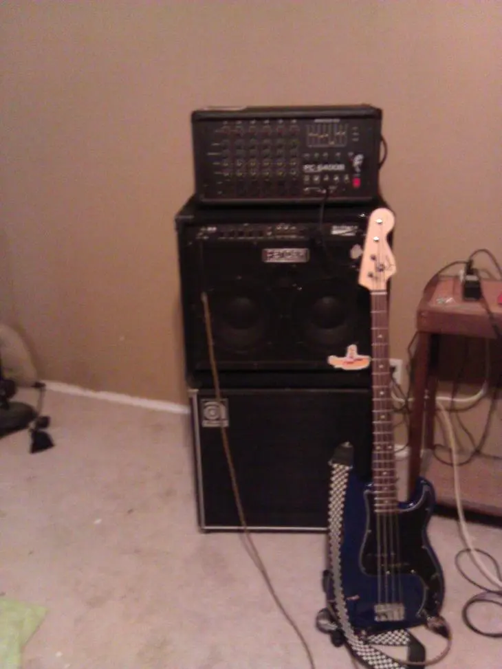

Hooked up the 100 Rumble and the line out to the 400watt PA, going direct-in to amplifier and wow!! I think the combo of the Rumble 2x10 adding the new 15" is great.
the problem with the PA was crackling pots, but this setup I dont even need any knobs, just Line out to Amp In. The Rumble has the Line Out knob.
Very happy with results and very noticeable (and cheap). Turning the 400w/15cab off now makes the Rumble sound even worse, thin and empty....which just goes to say you can't go backwards.

The drummer heard the "improved-setup" and couldnt believe the difference either, its like a adding so much low-freq's to the Fender Rumble 2-10's, really cool.
the next gig should be interesting.
