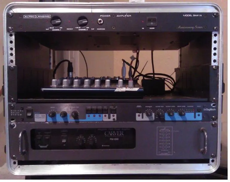

So far this is the PA power and mixer.
Yammie MG10/2-
Yammie Out A- to a Digitech 24bit Effects unit Reverbs/Doubling/Delays etc-> to the Carver amp to 2qty PA speakers.
Yammie Out B- to a Altec Lansing 9441A 200watt bridged for the drummers monitor.
I also found a Samson SCOM1 dual comp/gate/enhancer etc...for $40 I'll get later this evening.
Colorcoded the setup for the musicians.
Here's the setup so far- pretty cool... small Yammie MG10/2 feeding the FX unit, and Carver to Main PA, and the C/R out of the Yammie feeing the AltecLansing poweramp for the drummers monitor.

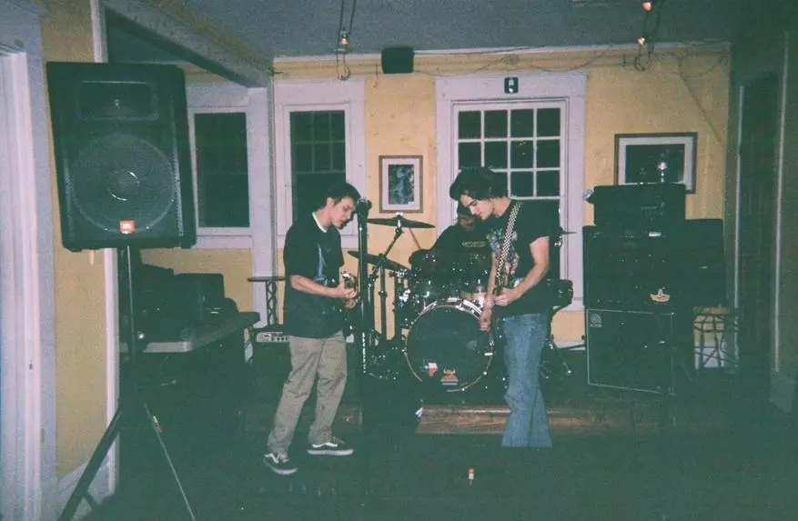

Found a small gig using one pa speaker.(someone elses speaker in this pic..)
Coming up are some outdoor gigs so more power and speakers are needed.
also- color coded simplicity and some homemade Switchcraft....
