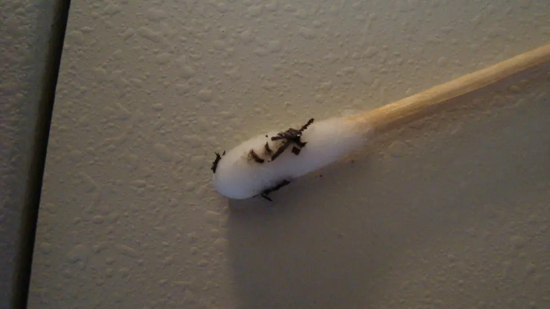

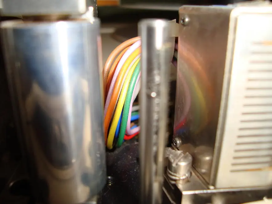

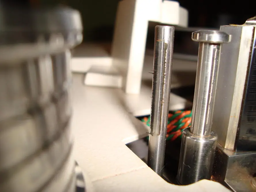

I ran my MRL tape through my new (to me) mx70 and all of this came off. Ran less than a minute. Is this sticky tape shed? It is a different color than I've seen. Is this magnetic? it wasn't on the heads. Just where you see it.

I can't see any pictures... MRL tape shouldn't shed, and if it does, send it back for a refund or replacement.
Yeah try a repost of the picture - I would like to see what this gunk looks like.

Thanks for the Albini quote. Ran into him here in the Land of Cleve 10 years ago or so (he was working with Craw). However it doesn't tell me what the crap is.
It looks like "sticky-shed" to me. And even if it's not, I'd say it's time for a new alignment tape.
Talldog, I think the oxide is flaking off..."Tape Shed"...not sticky shed per-se, but in the same family of aggravating issues with that era of tape. Baking will not help an issue with shed.
Guys, am I on target? Does it look like tape shed to you?
I'm surprised to see it sticking to the lifter like that.
ew..:eek:
hmmm I'm inclined to think madAudio is right. When I bought my MX5050 2track the owner thought there was a transport issue with the machine, but the only the problem was that some sticky shed tape had been run through it.
The crap on the guides looked a lot like your picture.
after very thoroughly cleaning the entire tape path things went back to normal..
maybe that mrl should be retired.
That gunk is definitely tape. Several of the machines I now own came with muck just like that all over the transport.
**EDIT**
Re-reading the original post, it's interesting that it's apparently only on the guides. That suggests to me that the guides may be worn.
Occam's razor dude. its definitely sticky shed tape. I ran some old 456 on my Tascam 38 and the tape path looked exactly like that when I was done.
get a food dehydrator and bake the MRL for a couple days, it should be good enough to calibrate the deck. Close enough for rock n roll.
the guides on my MX5050 are a little bit worn, but the tape path doesn't look like that after running new SM911. I'll bet if you run it long enough it will end up on the heads.
The tape is dated 1985-12.
If I'm not mistaken, most, if not all of the MRL tapes dated until Quantegy took over, in the mid 90's, were produced using the old Ampex formula, which had the bad binder.
Your MRL tape is right in the middle of the worst sticky shed years and is obviously coming apart on your tape transport.
I certainly would not use that tape.
That is definitely shed - it is oxide/glue scraping off on teh ransport, you should clean thoroughly and DEMAGNETIZE. Some people say you don't need to demag, but guess what? If you didn't need to it won't hurt. But in my experience (especially lately) you will need to demag.
