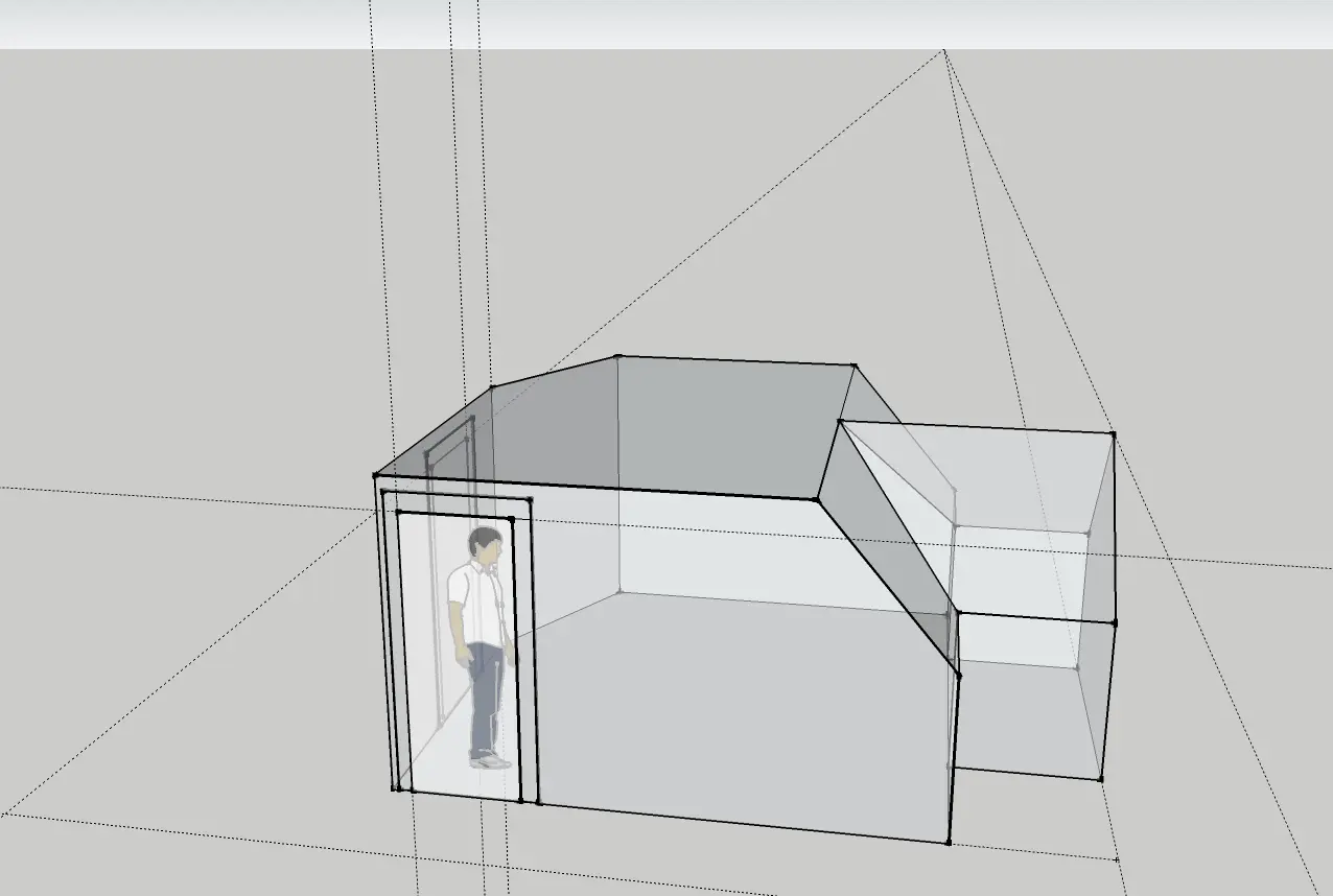

This one's going to be fun - ahh, the joys of living and recording in a room in Boston. :D
The gist - I'm moving to a new room in my apartment, which is a little bigger than the one I have now. I'm in the middle of repainting it now (it REALLY needs it), and when finished I'll be moving in and, eventually, building and installing a few broadband absorbers.
It's almost a 12x12' box, but it has a corner lopped off, a partially angled wall, and then a little extension (and really, it's more 12x12'2"). It also has to hold a queen sized bed and a dresser, plus my amp and a few odds and ends. The bed basically has to go along one or the other of the unbroken walls.
I just ordered a new desk - the logical place to put it would be centered on whatever wall my bed isn't, but dimensions are 59" and change at the longest edge, but it's a little tapered so it MAY fit snugly against the little lopped off section, which actually wouldn't give THAT asymetrical a mixing space, though the slanted ceiling would compound things slightly.
Thoughts? What would you guys do with this space, both in terms of layout and of treatment? I'll post pictures of it in progress later, but for how here's links to the Sketchup file, and then a layout shot.

After viewing your drawing and if the guy in the picture is a representation of you and you plan on getting laid in your studio .....
I suggest an all new line of wardrobe! :laughings:
:cool:
Very helpful. :rolleyes:
:laughings: No, that's just the default sketchup dude that's already there when you open a template. I didn't bother to delete him - I'm not sure if you can. :laughings:
There's an option to remove him, but that's probably the only thing I know about Sketchup. he does help give a perspective to your room size.

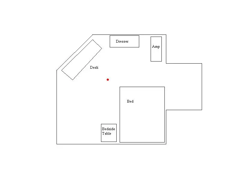

So, I moved in (sorta) last night. I'm thinking of laying it out something like the attachment, red dot being approximate monitoring position. Acoustically, with the slant ceiling and the corner behind me would that be a disaster? At the very least, I'm thinking I'd get very few direct reflections off the surface behind me, but a lot of indirect ones.
Also, this is an acoustic space I'll be tracking in - mostly electric guitars, but also acoustics, the occasional vocal, and hopefully drums.
EDIT - that's assuming the desk I just bought fits there - if not, I'll be moving it to where the dresser is, most likely.

You don't want the slanted ceiling behind you. You want the room to open up behind you, so you need to be facing that alcove. I know it's not what you want to do, but that's the right thing to do acoustically. That said, you also have to live AND track in there, so...
Ditto Frank.(no time for the rear wall)

I'd stick the bed in the alcove, and put the mixing position between the two parallel walls, so that you will have symmetry in your listening position.
